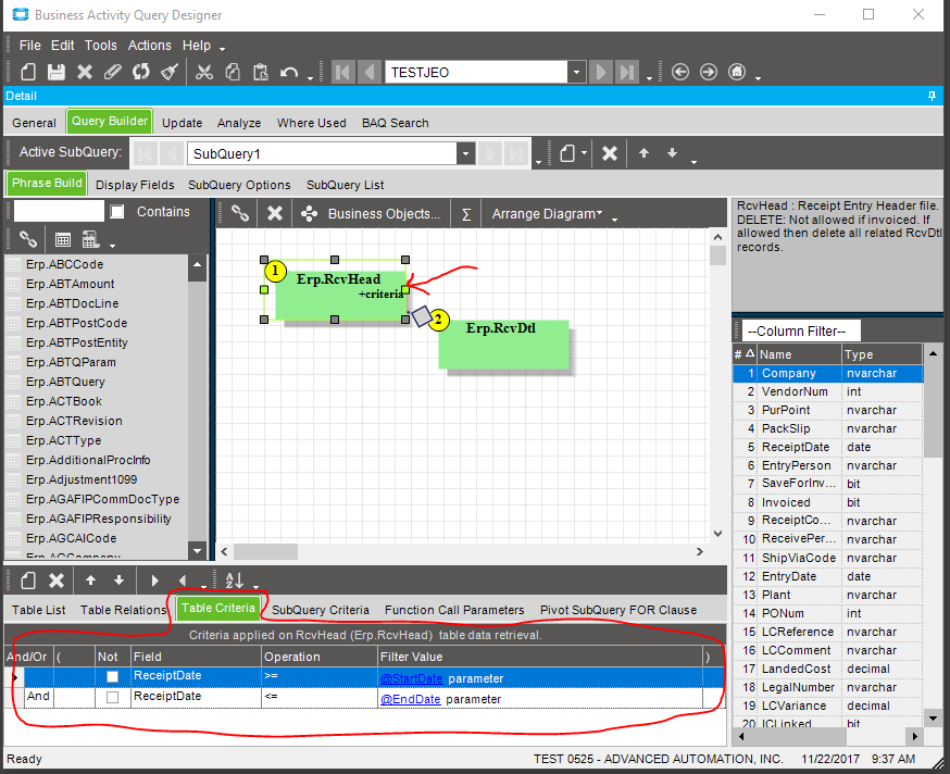

Using BAQ, How do I set up a query that can display only records within certain dates range?
This is pretty trivial in BAQ , checkout the User Experience and Customization Manual and the ICE Manual
You will need to add a table criteria to your query for the date range. Do you need screen details? Usually you select the table in the query designer and then add a criteria/filter to the table for the column you want to test.

Here is a few screen shots. This is a short query to pull receipt headers and details lines between a start and end date. This has input parameters built into the BAQ. I created the parameter StartDate and EndDate. The BAQ request these at execution time.
Start a new BAQ. Add the table(s) you want in the query. Add Table Criteria to whichever table you need to. Set the filter value to be X parameter name. Then, select the fields to be part of the query. Test to the query for results.
This is a test database from May 25 so this is why my dates are so far back.
Click OK and this is the results
