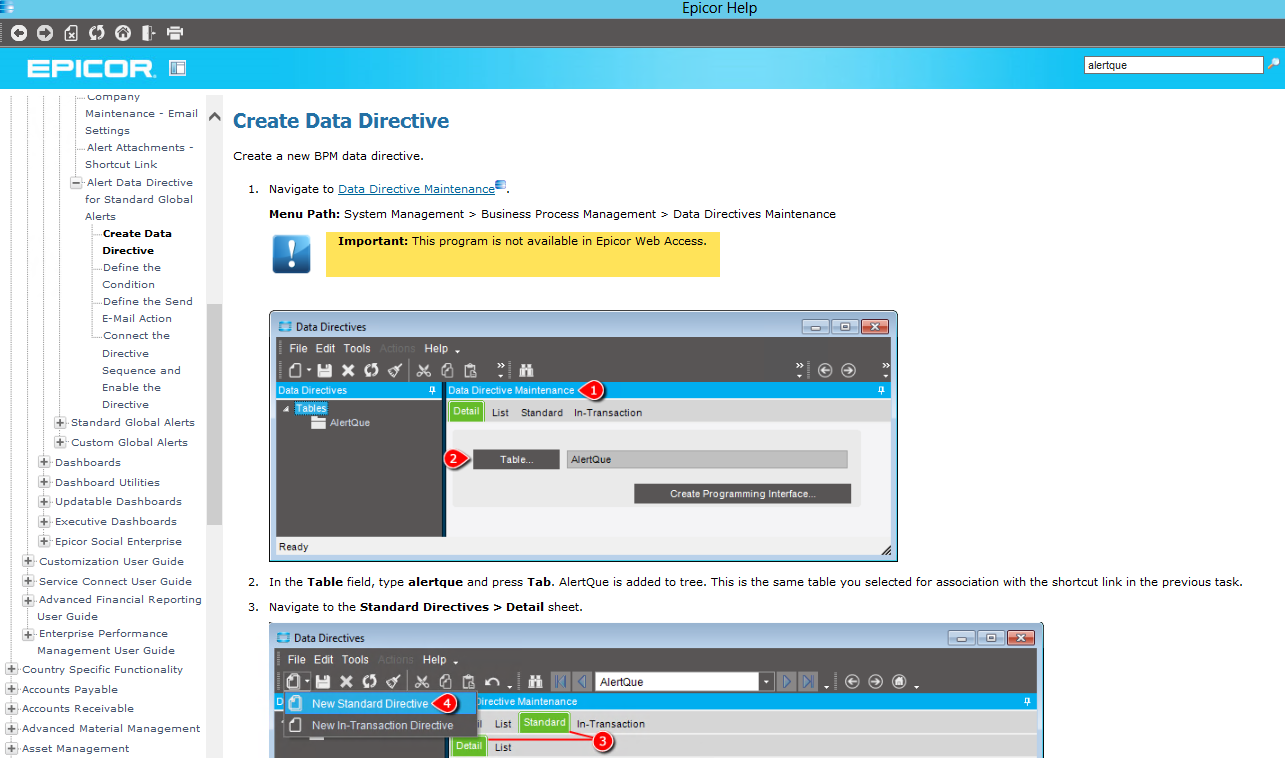

Do you have more than zero records in Ice.AlertQue? AlertQue is where outgoing emails that are processed server-side from Epicor are queued before being sent. In all E10.x versions, a data directive BPM on ICE.AlertQue is needed as that replaces the “global alert email server process” of earlier versions. The instructions on how to create that data directive BPM on AlertQue is available in the Application Help (I search for alertque to find it quickly)

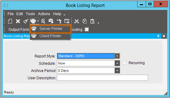

Another way to test if the email settings are correct without creating a BPM in E10.1 is to send a report via email (assuming you have server-side printing enabled on the Company record).
For example,
  1. Navigate to Financial Mgt > General Ledger > Reports > Book listing.
  2. Click Print button on toolbar and select Server Printer.

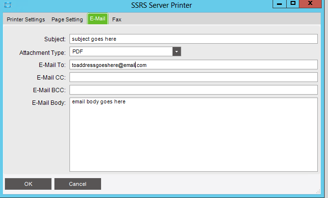

  3. Click on the E-Mail tab and populate the appropriate fields then click OK.
