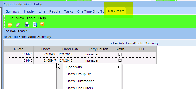

I think the easiest thing would be to make a BAQ and dashboard then embedd the dashboardon the Quote form (use the SHeet wizard),
It would show every Order that was made from that Quote. And the user could just right click on the OrderNum, and “Open With …”
LIke:
