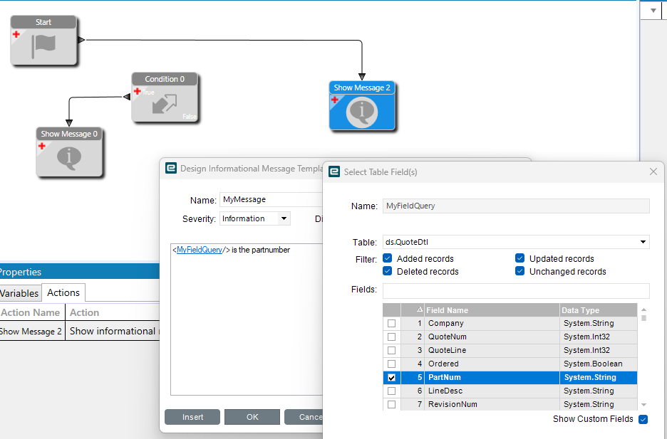

On the Quote Entry screen, I want to look for certain part numbers and display a message for those part numbers.
I am trying to do this with a pre-processing BPM on Quote.update, but at the point of the update it is not seeing data in the QuoteDtl table.
To test this out I put a show message box in the BPM that will show me the partnumber from quotedtl. I get the message but no part number.
How can I hook into the QuoteDtl table to get the partnumber?

If you want to show message when users add something, you might need to do In-Trans- Data Directive for QuoteDtl.
I am trying to show an informational message if there are certain parts on the quote.
My understanding at least… a pre-processing will happen before your Quote Entry adds any NEW records to the QuoteDtl table.
So, yes, I think you’re correct that its a timing issue and you’re trying to look at/compare new records before they’re written.
You could use your pre-processing method containing a condition on the desired new QuoteDtl rows and if true, enables a Post-Processing directive. Then create a post-processing directive which returns your message and see what comes back.
So, your pre-processing would perform a condition check… Epicor would perform its magic and create the new quote lines… once created, the post-processing would kick in and pop up the desired message.

The Update method is equivalent to Save.
So this BPM will run whenever the QuoteEntry is saved - is that the right timing?
There may be a method that runs more timely - like ChangePartNum (Updates Quote Detail information when the Part Number is changed.)
That worked. Thank you!
