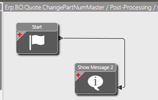

Post-Processing on Quote.ChangePartNumMaster
Two widgets: Start and Show Message:

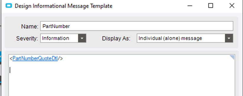

Message:

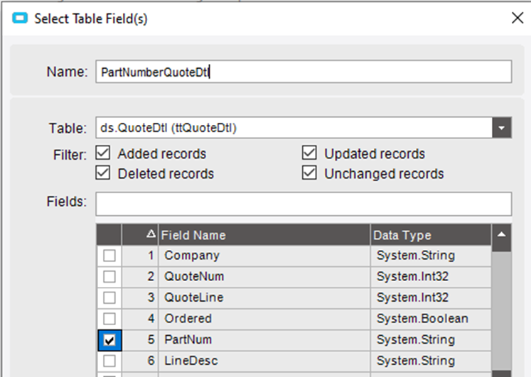

Query field:

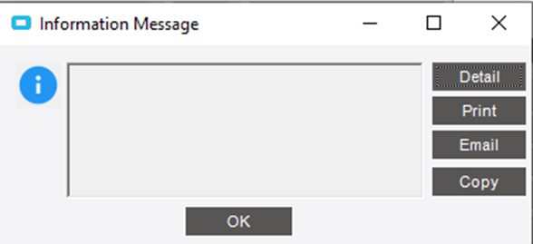

When I enter a part number on a quote line and tab out of the field, the message box pops up, but it is empty:

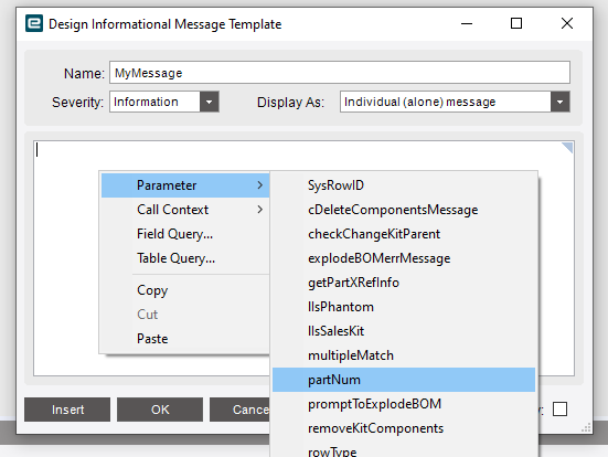

A lot of times there is a parameter passed in addition to the dataset that contains the data that’s changing. Is there a PartNum parameter? Perhaps that has the part number in it.
How would I check that? A trace? I did a trace and it had the actual part number in it.
In your message box, right click and see if there is a parameter already defined in there for part number.
Thanks that was it! Now to plug the parameter into the comparison…
