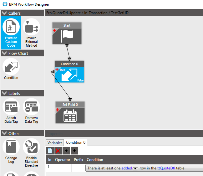

  • A pre processing BPM on erp.quote update on the ttQuoteDtl table, using ‘execute code’
    and ‘set field’ using custom code and am getting into a mess.

Hi Karen,
Hopefully I’m not telling you of a method that’s not preferred by experts here, as I’m not expert either, but have worked on similar tasks as yours. The problem I’m having with below is with the quantity update business, which seems to be throwing the update off when I put quantity in for a new line. I’m not sure if it’s due to other customizations/bpms etc. or going to be there for you too. However, I do see this code working on QuoteDtl post processing Update bpm method sometimes (leave qty = 0). It could also work in Data directive for a changed QuoteDtl.PartNum field, but I wasn’t sure what to do about new…So, it works, and I recommend you consider it and tweak condition until you get it doing it all the time.
My condition:
My code:
Hopefully this helps you get there.
Nancy

Thank you - this works when first creating the line in the quote.
It doesn’t update if I change the partnum but that’s fine, I can work with what you have given me so far.
edit - added a new condition to also run when the partnum is changed from any to another, then set the field as per above and that works too now, when changing the partnum :slight_smile:
