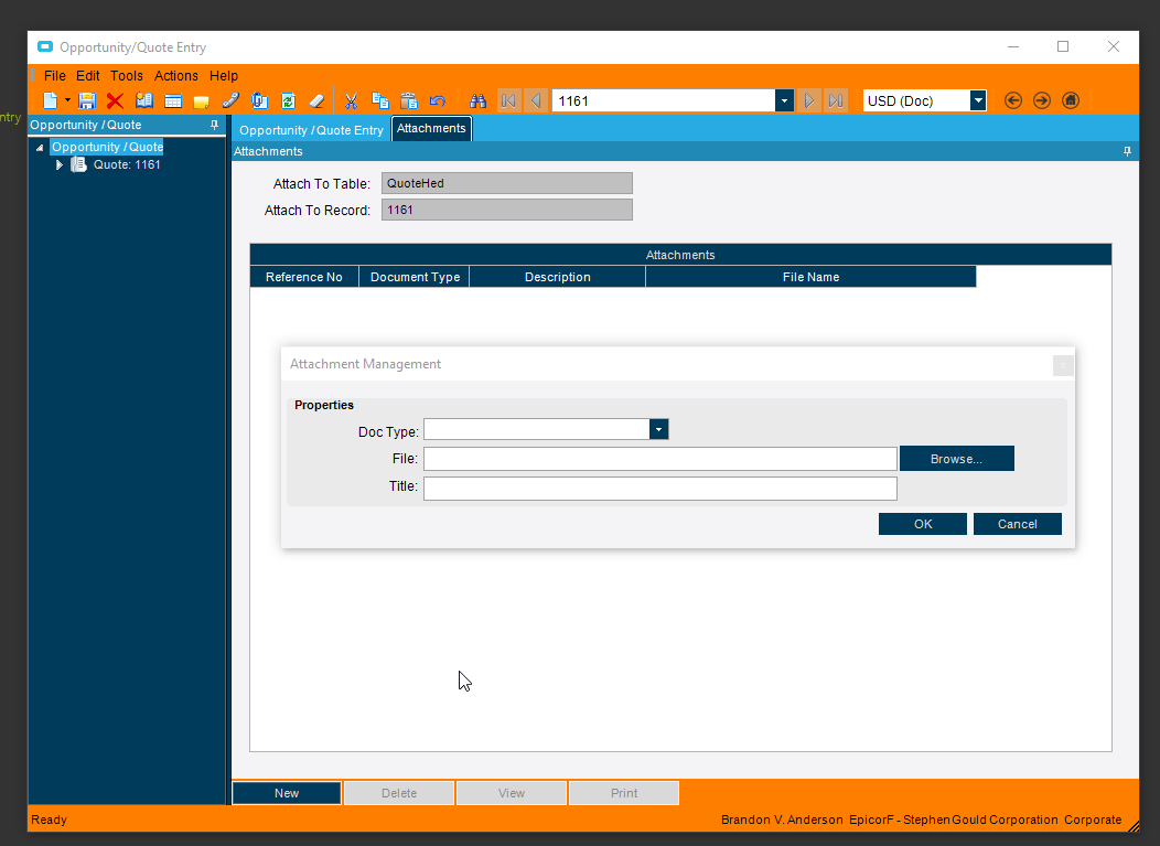

Does anyone know if you can add an attachment to a Quote? It seems like I can only add an attachment to Orders. I try the same procedure for attaching an attachment to an order as I did to a Quote and it isn’t working.

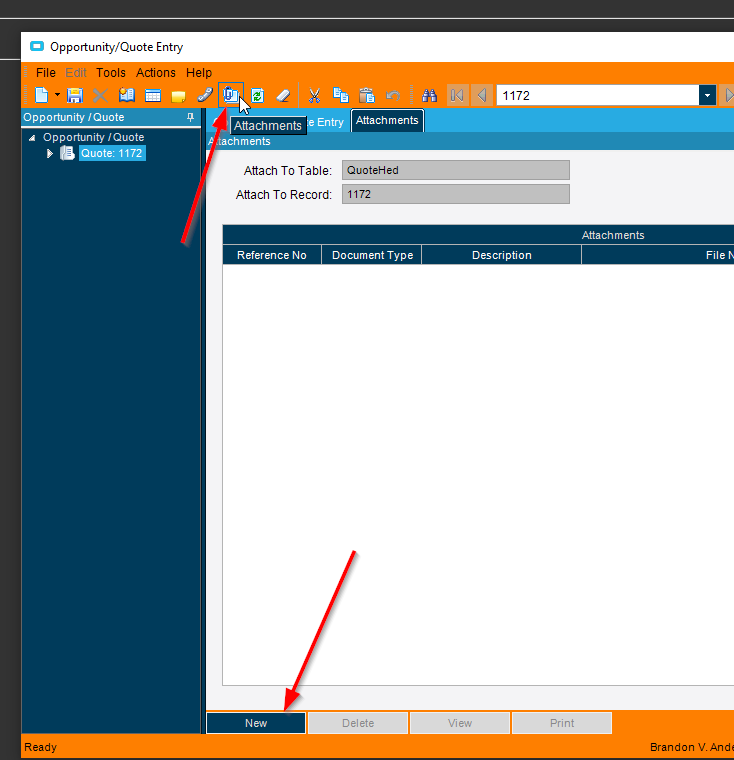

Just click on the attachment in quote entry and attach. What are you seeing where “it isn’t working”?

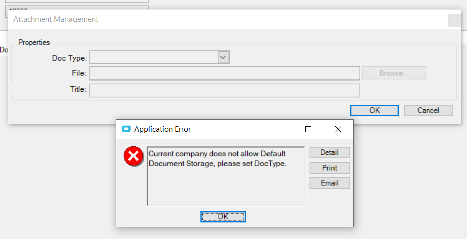

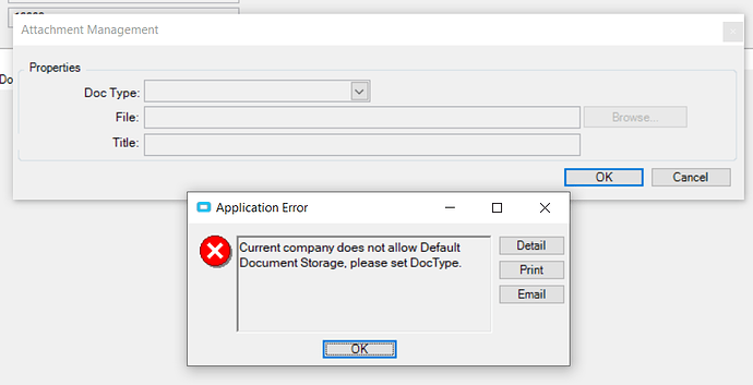

When I try and attach a file the attachment management screen is greyed out and when I select ok this is the error I get.
Review the Setup in the following Screens:
  1. Attachment Type Maintenance
  2. Document Type Maintenance
  3. Document Type Control
Did you recently upgrade to 10.2.600?

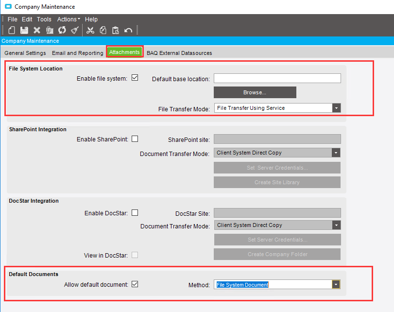

Confirm that the relevant settings have been enabled and setup in company maintenance .
