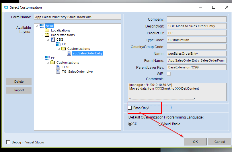

Try opening Order Entry (BASE) and re-open the order that way. Does it work then?

If you run it as Developer you can select “base Only”

Just FYI your suggestion worked perfectly in our test environment which I have all access in it…so requested the needed access in Production…thanks so much
