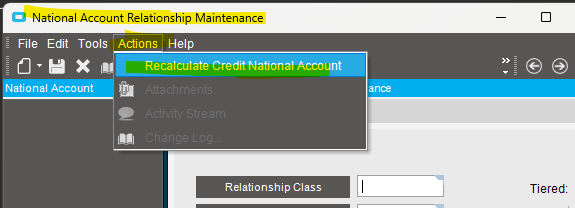

These weren’t national accounts were they Jose?
yes they were
yeah, the only way I could ever get those to recalc was using the “National Account” version of recalc credit, found so easily through the actions menu in “National Account Relationship Maintenance.”
But I can’t tell from your posts whether you ran this one or the normal recalc credit.
Also don’t know if this program touches global credit, but I assume it does…
We tried running that and it almost crashed our servers that was a fun adventure
:upside_down_face:
Even when the Recalc Credit Nat’l Account process completed it didn’t fix the issue for us. We have had to request this same fix three times so far.
