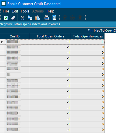

We made a dashboard that shows the customers which need to be recalculated, and then filter the recalc to just those, and run it on demand. Runs much quicker, but it’s still manual. I’ve thought about running it wide-open overnight, but we’ve got 1.4M customers in the db.
Maybe it’ll highlight some accounts that you can test with, after the fact.

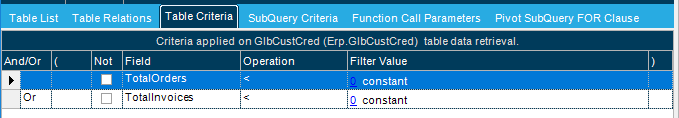

Here’s the BAQ for it, which shows customers that have a negative # of orders or invoices in the GlbCustCred table:

The GlbCustCred table probably is off. The secret key we found was when it showed a negative number of orders or invoices. No idea how it gets corrupted (Bryan’s ideas might get you somewhere), but it’s common enough that Epicor has a process to fix it.

We run the Recalculate Customer Credit app monthly. Credit department will filter the customers using a dashboard that shows a negative number of orders or invoices. Don’t run it wide-open, it’ll take forever if you have as many customers as we do.
