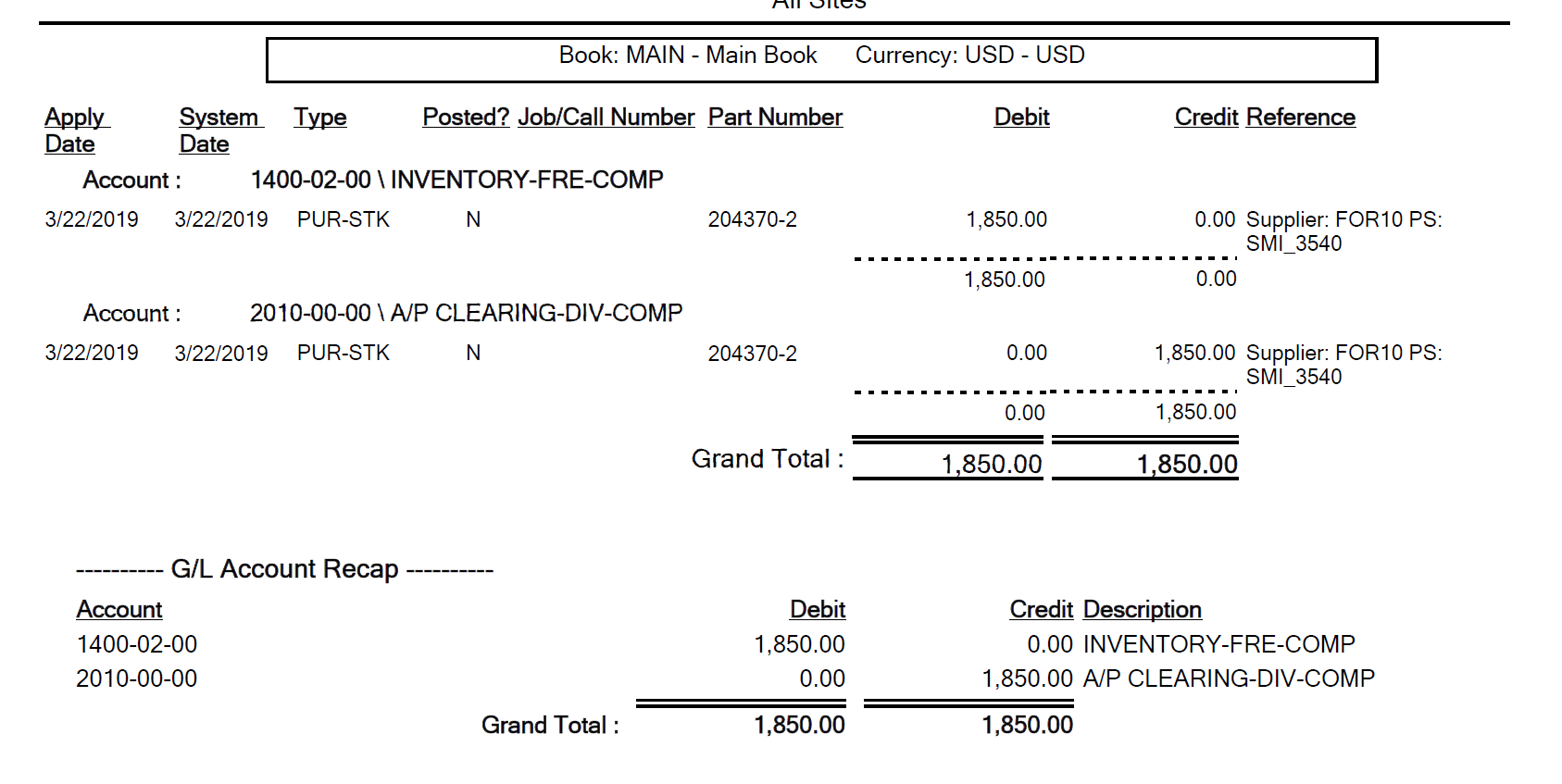

FWIW - That field solves your problem but where did the receipt post or did it not create GL entries with COS/WIP? If it did and you use a clearing account your subsidiary ledger “Receive No Invoice” report will not balance the GL clearing account if it is not invoiced.
We bring in the inventory from SMI.
Debit Inventory
Credit AP Clearing
Then I created a Inv Adjustment Reason Code tied to GL 2010 AP Clearing.
SO when I do the adjustment and chose SMI Inv Adjustment, the following happens.
Credit Inventory
Debit AP Clearing.
Then I clear the checkbox for Saved for Invoicing.
