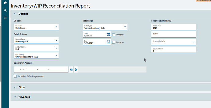

The Inventory / wip recon report is more of what you might be looking for. It should show you the change that happened within the period. but note that it is very complex… you can look at it for a specific gl account, and/or a specific date range.
