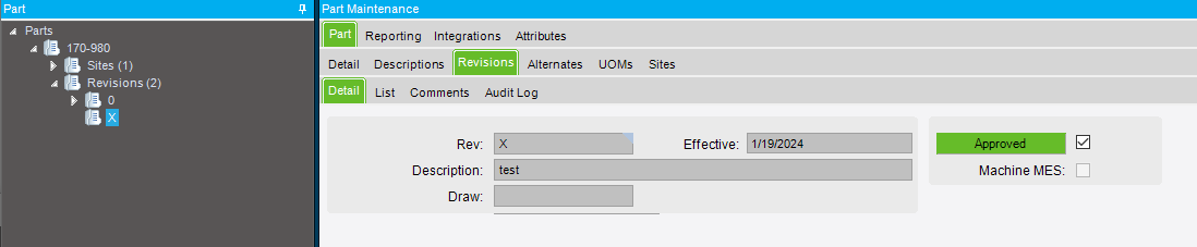

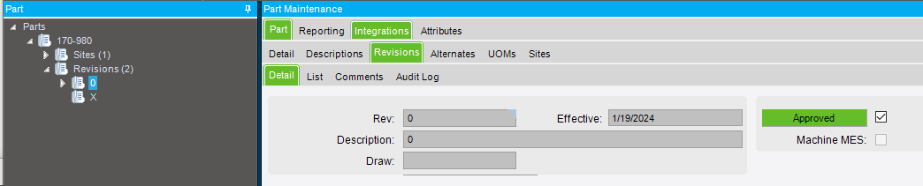

Dan thanks for posting this, I’m trying to fix the multiple-rev issue as well.

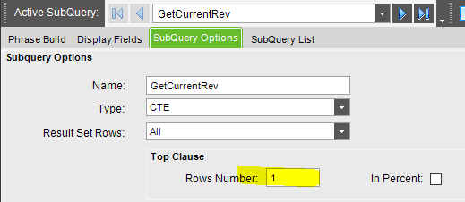

Issue though - In your query, if you have 2 revisions for the same part (component or parent), with approved on the same day/same effective date, they show up as duplicates.
You have the Rows set to 1, but it apparently has no effect…
Workaround might be to combine the EffectiveDate and SysRevID field together into a number… though that might have performance issues.
Or just go off latest SysRevID, though if someone updates an old revision record, not wanting to change effective date, the BAQ would pull the older rev.
I’m still thinking this over.
Same issue here…
Yep that’s a limitation for sure. We don’t typically have multiple approved revs for the same effective date so that wasn’t a show stopper for us.
