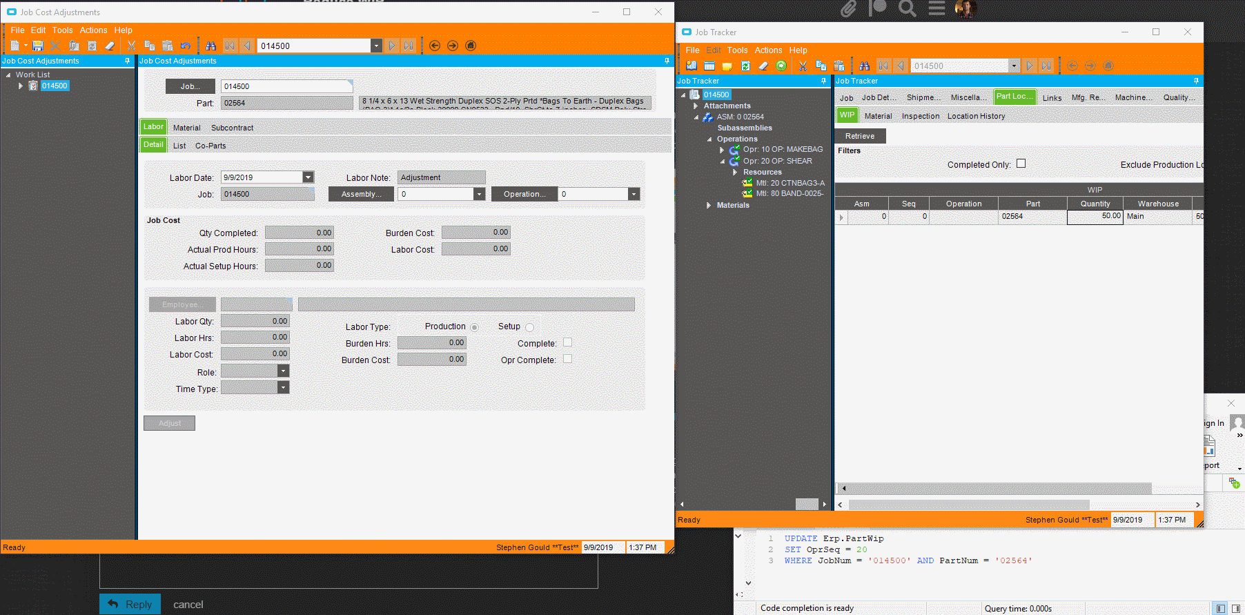

No auto receive naw. Here is a gif where i show the final operation is 20. I job adjust on 20 -10 but WIP remains 50. Note though that the WIP is no longer on an operation sequence after reported from final operation. I believe that’s the issue, but just part of they system I’m not sure how to get around.
Confirmed if I go into the database and force that WIP back onto operation 20 I am not able to adjust it with Job Adjustment. I can however do it then with Adjust WIP. Obviously not a solid workaround, but confirms the logic path of Epicor. Does it have to come off the operation sequence when completed on the final operation, I don’t know of a setting that would stop that? A gap in the logic?
Trying to adjust WIP with Job Adjustment after changing the oper seq on PartWip
