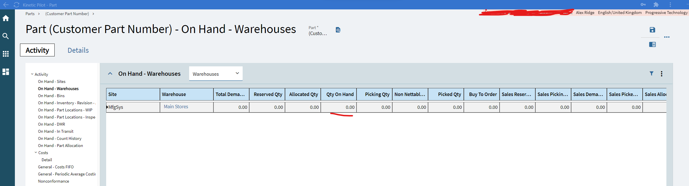

Hi @Jeremia ,
I am assuming the UI you are referring to is “Part” and you are using Kinetic screens.
As an option you could build the logic into the UI by utilizing row rules, the dataset for inventory is already there so in theory you could utilise row rules to make the Part Category field Read Only / Disabled.
