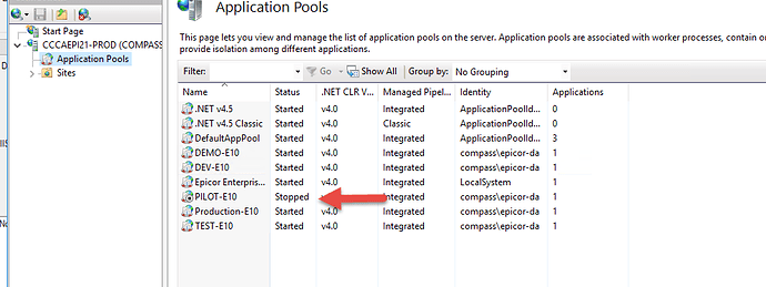

In the IIS Manager I see the two databases listed on separate lines

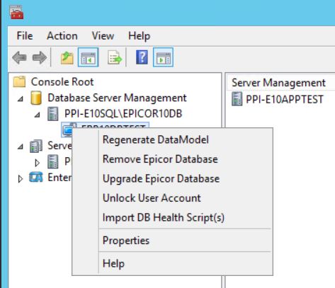

The process to regen is a 2 step.
First you select the database in the console and Regen.

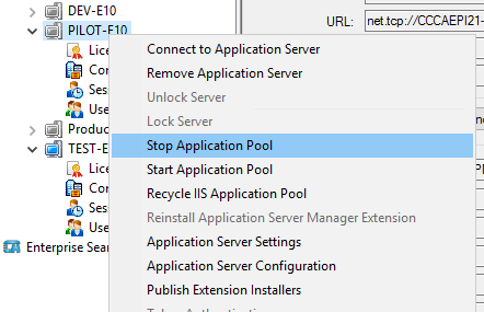

After, you select the app server in console and Recycle

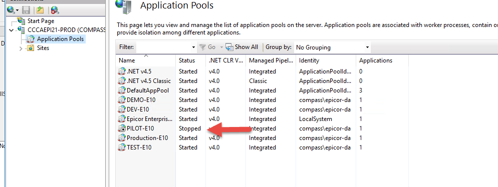

I just stopped my Application Pool for Pilot
and logged into Test.
Also you must be on the database not the app.
Right click and you can see the regen option.

Snap a pic of your admin console - the app servers will be named appropriately.
I am not RESTARTING IIS APPLICATION POOL (SYSTEM), I STOP APPLICATION POOL (DB SPECIFIC)
Okay, so there’s the difference.
