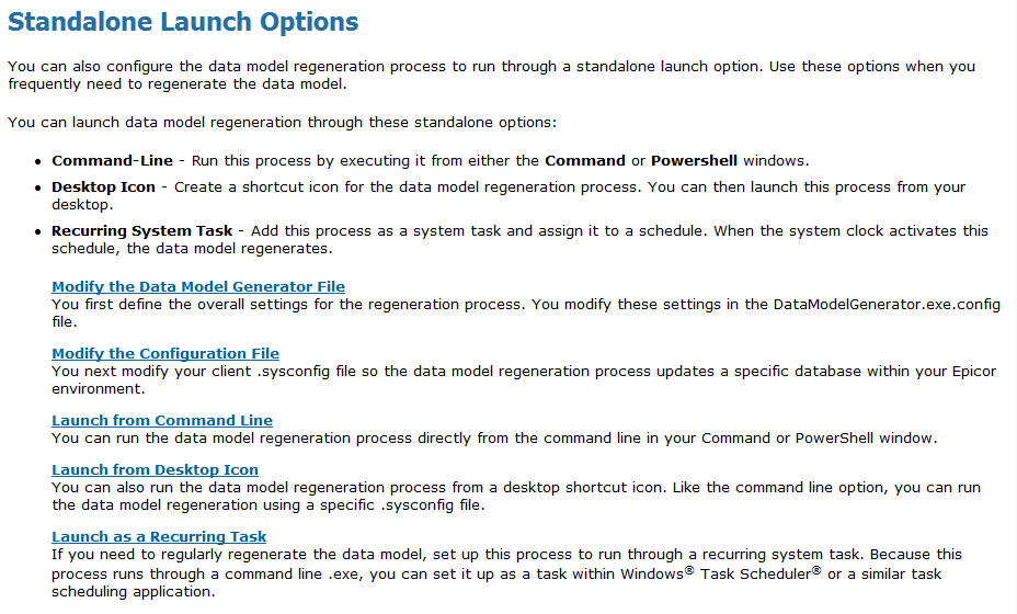

Is it possible to automate the data model regeneration? I know there is an executable DataModelGenerator.exe in the client folder, but it’s different that the version that runs in the administration console. Thanks.

Depending on the ERP version, in the EAC help, there is a topic called Standalone Launch Options under the Database Server Management parent topic that provides information on the various ways to trigger a Data Model Regeneration.

We are automating the regen as part of our E9/E10 upgrade process and we are highly customized. There is a point in the upgrade process where we have to regen a few times regarding index generation on UD Character fields, of which Progress allows but SQL does not (due to NVARCHAR(MAX) field format). We have a 48-hour window to get everything done and need to maximize our time wherever possible.
In the help file of the administration console, there are instructions on how to schedule the process as well as running through the console although they are not very clear, so there is a provision to perform a regen from a command prompt.
I will look for this, thanks. I saw the section on the Data Model Regen that touches on launching from the command prompt but the Standalone Launch section might be more explicit.
We have the start/stop for the app pool and task agent automated already. Just need to figure out the regen part.
