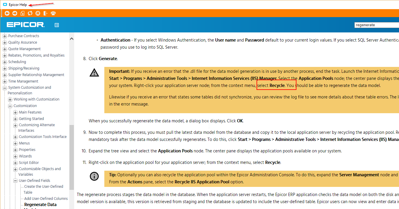

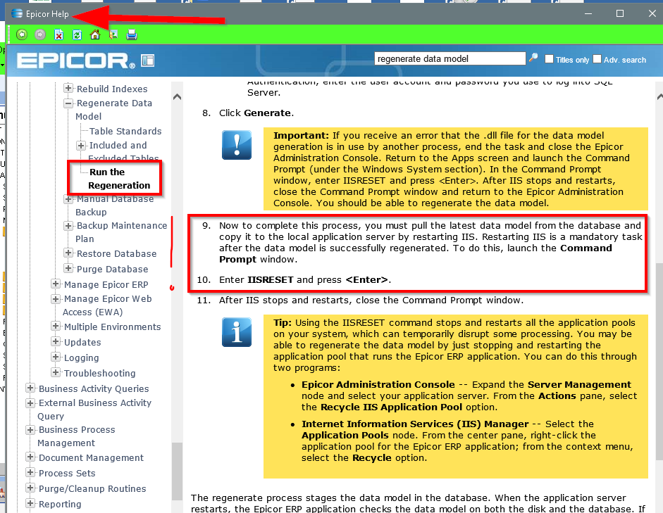

Like this?

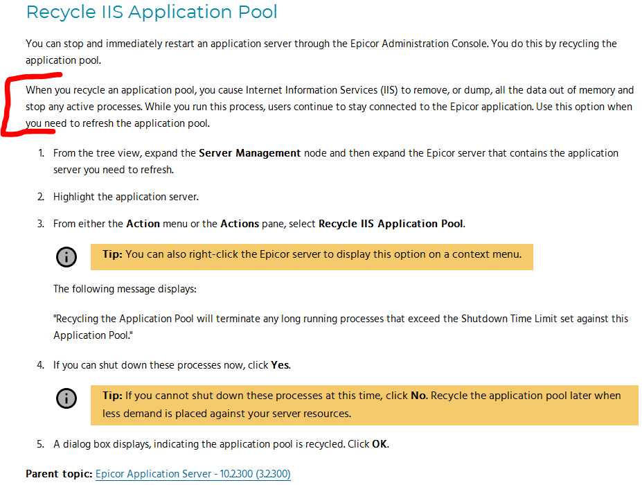

You shouldn’t be doing IIS Resets at all. AppPool recycle is your friend @aidacra is turning over in his office right now reading that

Here is the help file, I guess it needs to be updated?
Right that’s a Recycle which is different form IIS Reset

I’m sorry but without any Epicor knowledge/training or reading manuals, any experienced sysadmin, for example a new hire with no Epicor experience, should be dubious of regenerating a “data model” when the system is up and being transacted on and proceed with caution - which is exactly what Kalvin is doing in asking this question in the first place.
The same applies to recycling IIS.
