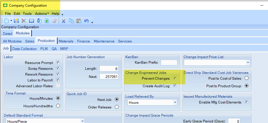

Hi Saul,
There’s a checkbox in company configuration called prevent changes on engineered jobs. Have you considered unchecking this to see if your updateable query works then?

Hi Nancy,
I can’t uncheck it because that is a condition of the company.
I removed the check to test and the error continues

@LMMoser here is mine that works. I had to add the ValidateJobDuomAttributes to get it to happen in my version.
EDIT: To @Nancy_Hoyt ’s point I do not have Prevent Changes or Create Audit Log set. I can try that in test to see if it fails.
