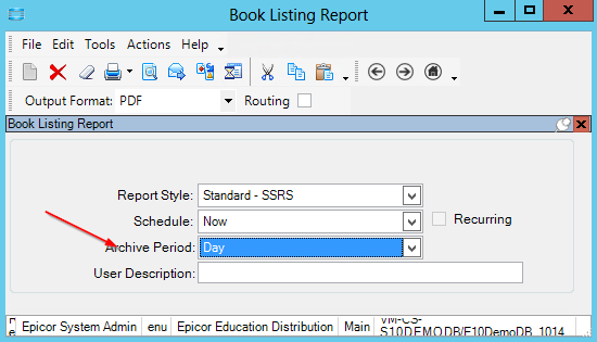

We are having trouble getting report builder fully integrated and working in our new 10.2 environment. I can successfully open the report and make and save updates, but when I want to view the report and enter the TableGuid found from the system monitor, I am getting the following error:
Invalid object name ‘RptLabels_0f8c10f38438473986224b7c443bee36’.
Query execution failed for dataset ‘RptLabels’. (rsErrorExecutingCommand)
An error has occurred during report processing. (rsProcessingAborted)
The reports run without issue from within Epicor, so right now, my only option is to make a change and then rerun the report in Epicor to view the changes and see if the outcome is as desired. Any idea where are issue may be that report builder does not seem to recognized the Guid?

Hi Patti, this sounds like an issue that was posted yesterday under another thread. Here is what I recommended:
Setting the archive period to Day seems to have done the trick. That was never an issue for me on previous versions. As long as it was still appearing in the report list in the system monitor I could always view it before. Thanks for your advice!
