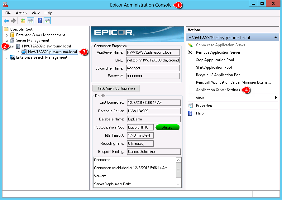

  1. SQL Profiler (lots of youtube videos on it)
  2. Epicor Performance and Diagnostics Tool - Via Admin Console you can Enable SQL Logging and then you can just read the log files in ServerLog.txt or use Epicor PDT to parse it for easier reading.
For more information you can download the Epicor Performance Tuning Guide Technical Reference from EpicWeb, it has a whole section on Server Logs, Profiling, Tracing.
