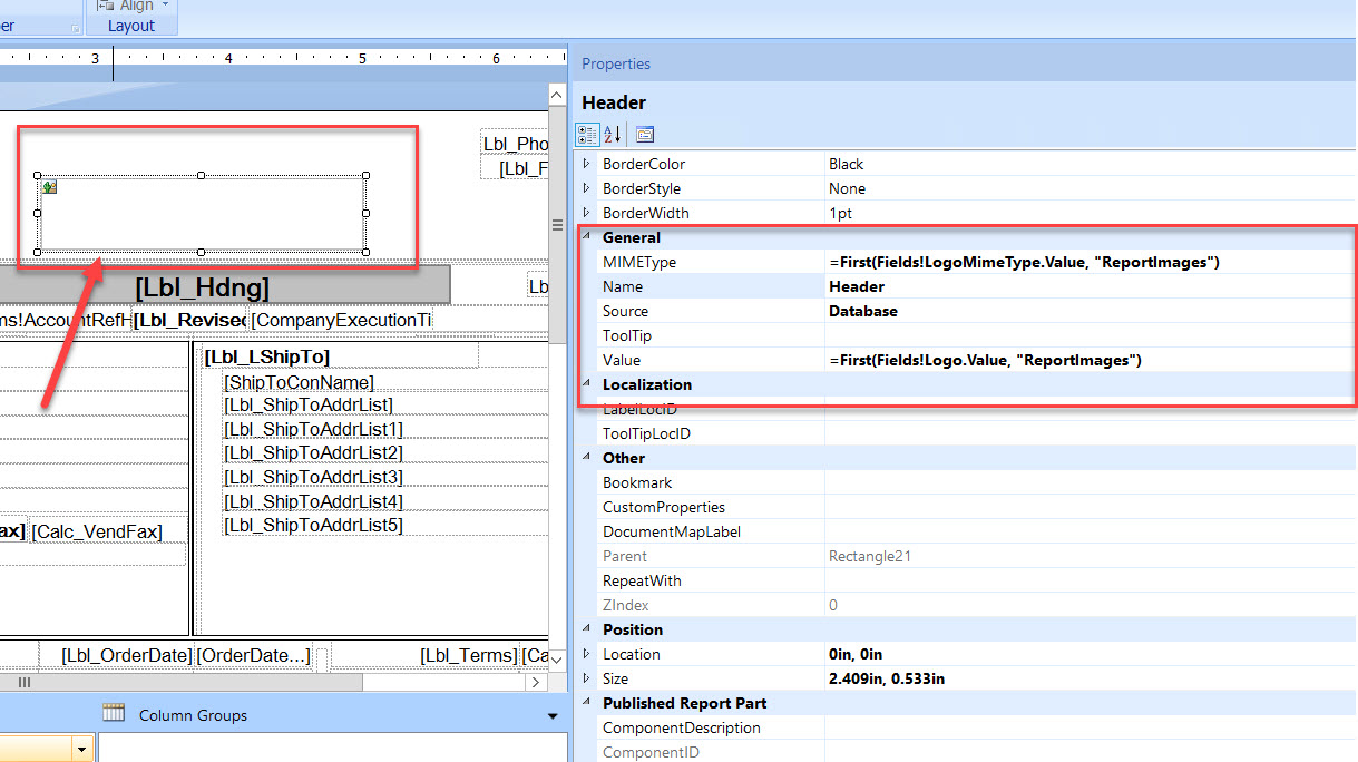

Report Images MIME data type
Looks like there is already a place-holder for images inside SSRS Reports.
=First(Fields!LogoMimeType.Value, “ReportImages”)
Where in the Application are these “ReportImages” stored? I have asked Epicor Support and they say you still need to embed the logo images directly inside the RDL. It seems like some functionality is already there to pull the image (logo) from inside the database. I just don’t know where to set it up.
Company Maintenance, at the bottom of the front page there is a Logo option. Not tried it myself yet, so can’t guarantee that is actually the one!
Refer to this KB on Epicweb KB0050698. As far as I can tell there is limited functionality, but I am checking with support on how it can be extended, particularly for forms that are mentioned in the list, but are CSF reports.
