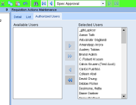

Requisitions Actions Maint has a tab for authorized users
Yeah, for Send To Purchasing, it is greyed out. So everybody should be able to send to purchasing, right?
I see that (grayed out Available users) for my Send to Purchasing too.

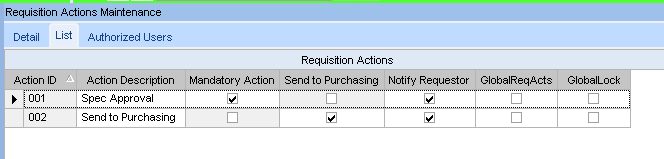

Here’s my Req Actions
Yours differ much?
No they are the same.
