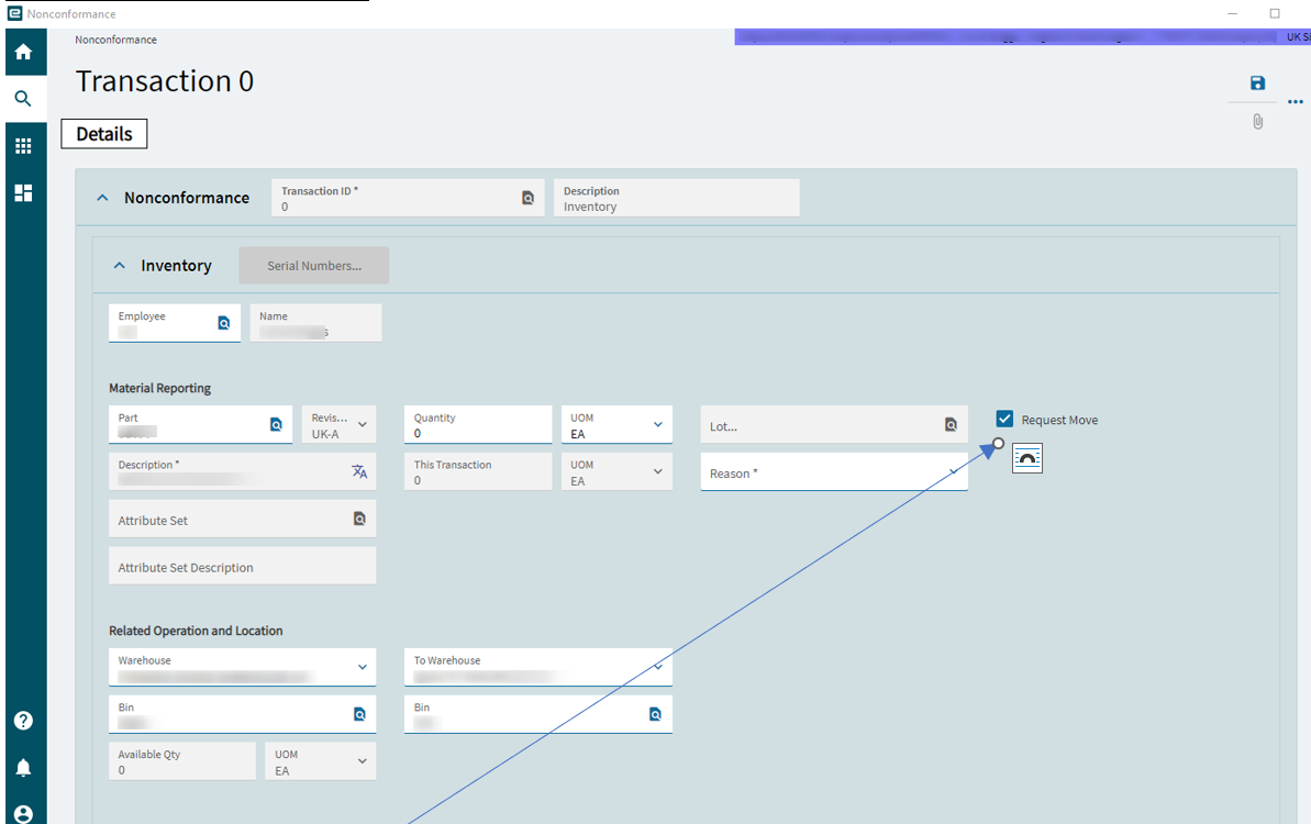

Request Move Box Default Unchecked on Non-Conformance
In Non-Conformance, is there any way to make the request move box unticked by default ?

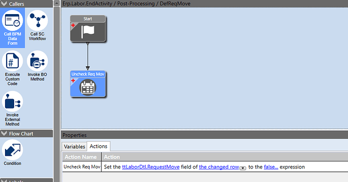

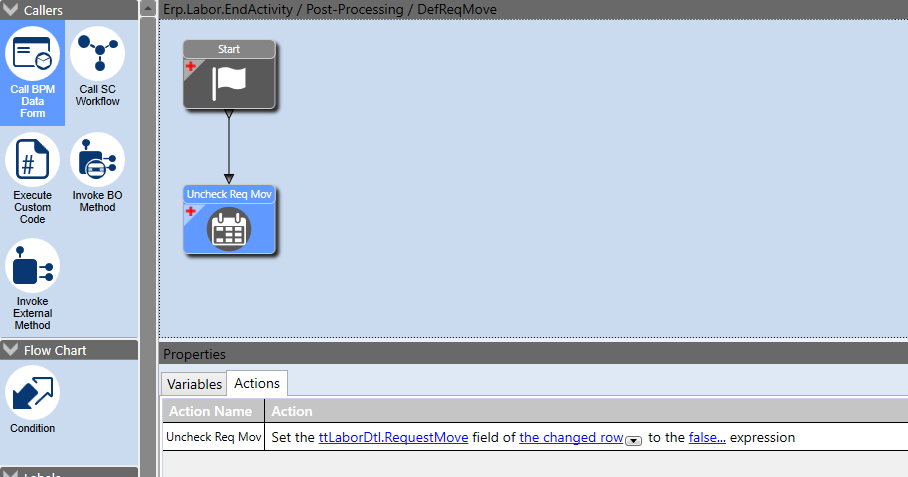

I do this exact thing for the ‘End Activity’ screen in MES.
It is a Post-Processing Method Directive on Labor.EndActivity with one widget.
I imagine doing the same thing on the BO for pulling up the NCF entry screen would work.
Interesting, i will give that a go, thank you !
Works a treat !
Put a post processing on NonConf.AddNewNonConfRow
