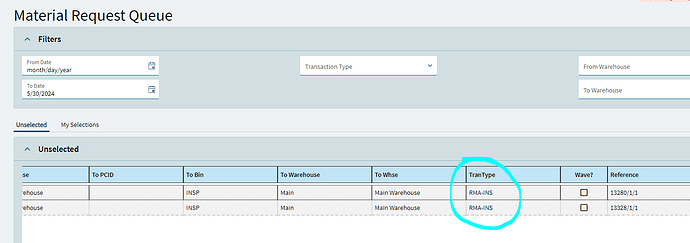

I am trying to figure out who/where/how the material request queue is being populated. I know there are several check boxes in various places. I found one on MES when they create a non conformance but it is not checked by default. I checked Inspection processing by not checked by default.
How can I figure out where these items are coming from?

What are the transaction types for the generated requests?

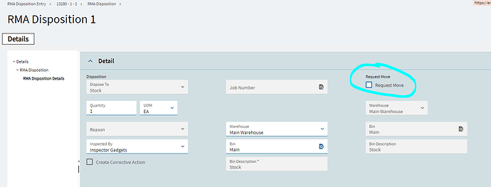

They are showing RMA - INSP. Is this when RMAs are being created? I looked at the RMA disposition and Request Move was not checked.
I believe those would be created when the RMA is received. I am not sure if there is an option to stop those from being generated. I know Epicor, in a few instances, generates move requests when certain actions are performed and the only way to disable them is through a BPM.
You could check here:
That was it. They left the request move checked on the RMA receipt. Thank you !
