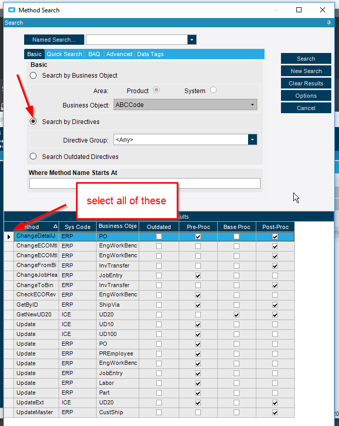

So if it was me looking, it looks like a BPM message. I would pull up all of my BPM’s and take a look through them. If you select <any> on the search by directive group, it will pull up all of your bpms. Even the ones that you didn’t set a group. Then once you get them in the window you should be able to pretty quickly look through them to find a message box that pops up that information. Maybe you have one on an unrelated method/table that’s doing some linq lookup across the database and throwing this message.

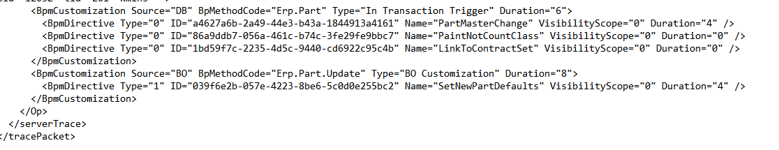

Also you can try BPM tracing. You should be able to see what BPM’s are firing.
Another thing to think about is, if you are using a code block, any messages that you display will not always fire in the order, or at the time you might expect them too. A better way to do that is probably to add tracing. You can record your values and you can see exactly when it quits. The pop-up messages can be deceiving.

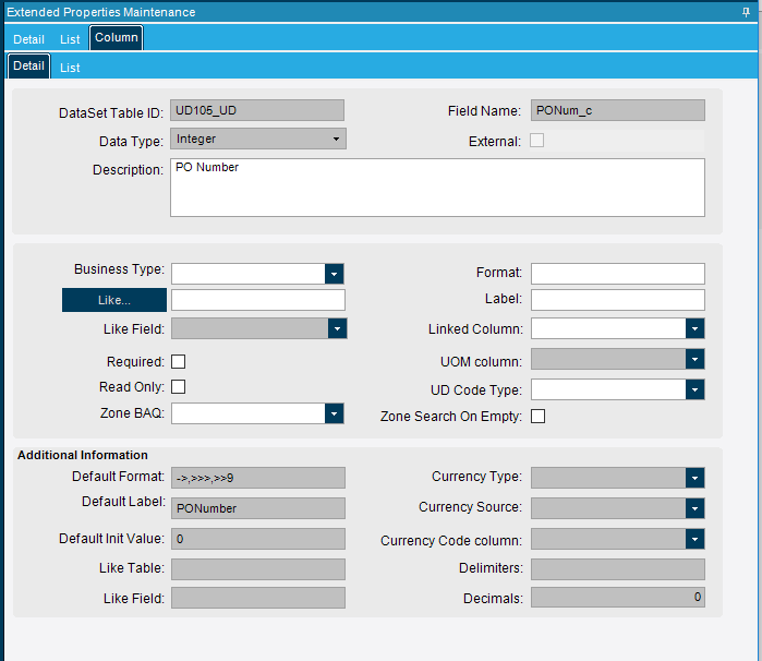

Last thing I will recommend is to take another look at the UD field properties. Pasts a screen shot here so we can take a look too. What type do you have for the UD field? Is it a nullable type? Are you sure that your PO is getting assigned in your code? Try the tracing thing to verify that. or even in your message box add ttIR.POLine.ToString() to see if there is actually a PO number being passed.

Well, after reviewing your code from the other thread , it’s clearly coming from your message box you have in there. I would bet it’s the settings on the UD field for the ponum. Can you post a screen shot for the properties of that field?
That would be correct, and the exception is passed back from the UD105 Update line, causing the message box to display. I assume you meant a screen shot of the POLine UD Field, but I will post both in case. I am working on the “personal” trace log this morning. Many thanks again.
I wanted the second. The integer type is non-nullable, which is why even though it’s not “required” it could be barking at you. Try setting that field to 0 somewhere before you try to really set it and see if it lets you finish.

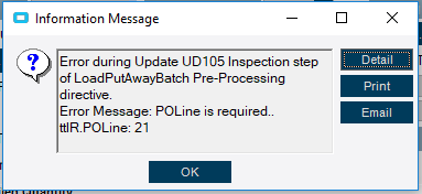

Set the value of ttIR.POLine to 0, but error’d saying PORel record wasn’t available. Makes sense since there is no line 0 on the PO. Tried to ‘hard’ set it to 1, still got the POLine is required error. Took the hadr set back out and reran. Pasted below is the error message with the ttIR.POLine value:

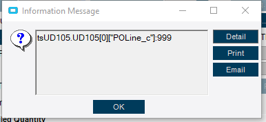

can you try in your message box the value of tsUD105.UD105[0]["POLine_c"] instead of the ttValue, to make sure it’s set correctly?
And what happens if you hardcode this line
tsUD105.UD105[0]["POLine_c"] = ttIR.POLine;
to something like.
tsUD105.UD105[0]["POLine_c"] = 999;
In essence, I already did that. I can’t display the actual values of tsUD105.UD105[0]["POLine_c"] or ttIR.POLine in the messagebox since at that point they are out of context. I created a global value of int POLine = 0 and changed the receiving line to POLine = tsUD105.UD105[0]["POLine_c"] = ttIR.POLine; and displayed POLine. I will try hard coding the tsUD105.UD105[0]["POLine_c"] = <correct line number> since if I use 999, I assume I will get the PORel record not available.

I am assuming that it is doing some sort of PO validation in the process, that is why when I set the value to zero earlier, it came back with PORel record is not available. I went ahead and set it to 999 (tsUD105.UD105[0]["POLine_c"] = 999; //ttIR.POLine;), and did an early display before the error to take that question out of the equation, but it still gets the POLine is required error.
