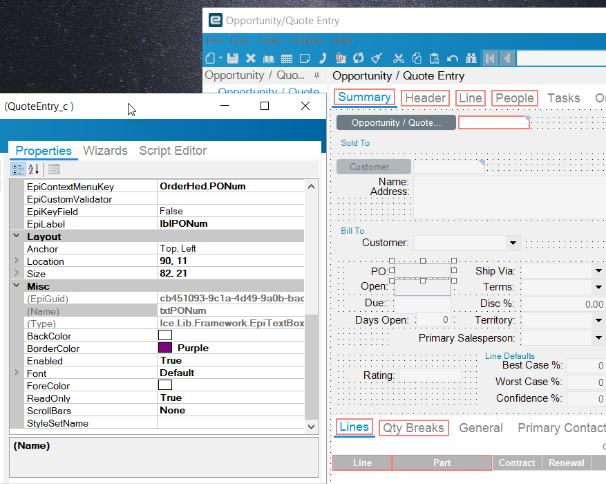

I am trying to highlight the border of EpiTextBoxes using the properties in Customization. They are NOT displaying the color. I have removed the AppStyling and I can see a border, but no coloring.
So then,
I tried to use some code that was in an older post (older than this one). @Chris_Conn you may recognize this…
EpiTextBox textBox = (EpiTextBox)csm.GetNativeControlReference(“blahblah-blah-guid-blah-blahblahblah”);
textBox.BorderColor = Colors.Purple;
This is the error I get and I have no clue where or how to find out which reference I am missing.
" Error: CS1061 - line 389 (1272) - ‘Ice.Lib.Framework.EpiTextBox’ does not contain a definition for ‘BorderColor’ and no extension method ‘BorderColor’ accepting a first argument of type ‘Ice.Lib.Framework.EpiTextBox’ could be found (are you missing a using directive or an assembly reference?)
Error: CS0103 - line 389 (1272) - The name ‘Colors’ does not exist in the current context"
THANK YOU in advance for any help offered.
@Marykay_Kowalski1 looking at this post they have Apperance.BorderColor
EDIT:
Add using System.Drawing; or use the color fully referenced
textBox.Appearance.BorderColor = System.Drawing.Color.Purple;
https://www.epiusers.help/t/combine-messages-box-to-single-box/75567
@gpayne Thank you! Your assistance has gotten the property to change - but it is still not displaying the color on the screen?? I have enclosed an image of the property value (changed) and the form. I did set the AppStyling to false and then changed it to true. It has no effect on the textbox displaying the set color. Any ideas?
Below is my code:
public class Script
EpiTextBox textBox;
	textBox = (EpiTextBox)csm.GetNativeControlReference("cb451093-9c1a-4d49-9a0b-baceeb8e989b");  //POtextBox control handle
private void QuoteForm_Load(object sender, EventArgs args)
 textBox.Appearance.BorderColor = Color.Blue;
@Marykay_Kowalski1 Sorry, No clue. I had not done a border color before last night. I would try turning off required fields to see if that is causing an issue.
