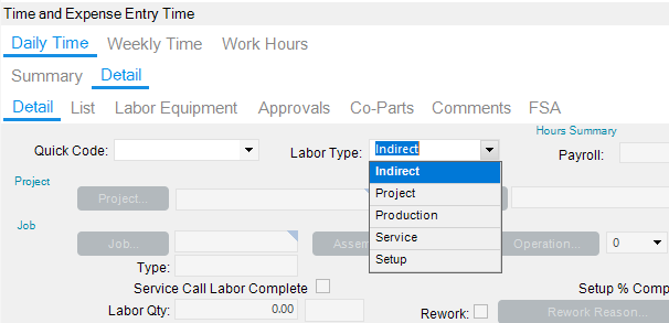

Oh, and I mean THIS kind of indirect:

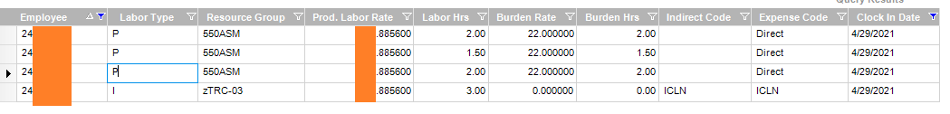

I see the labor rate coming from the employee’s rate, not the resource group.
Like here’s one employee. His labor rate ends in some bizarre decimal, but the resource group rate is a whole dollar amount. When he charges to indirect, the labor rate charged is his, not the group’s (Which makes sense to me.)
