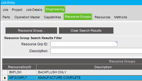

The Resource Group(s) listed in the Operation Details are used for scheduling the job operation. Every operation needs at least one schedule-able detail. It doesn’t necessarily need to be a Resource Group, it can also be a specific Resource.

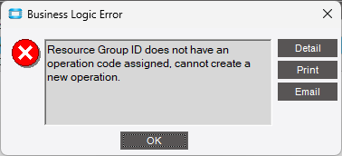

The Operation specified in the Resource Group is the Operation that gets added to the Job/Quote/Method if you drag the Resource Group from the Engineering → Resource Groups tab, onto the Operations node.
If you don’t provide that Operation, you can’t drag/drop that Resource Group when building your method.
I have personally never used this feature, I just discovered it when trying to answer this question. :slight_smile:
The Epicor Field Help does give a pretty good explanation.
“Specifies the default operation associated with this resource group. When this resource group is added to a method of manufacture (routing) during Job Entry, Quote Entry, or in the Engineering Workbench, this operation is the one used to create the operation sequence.”
