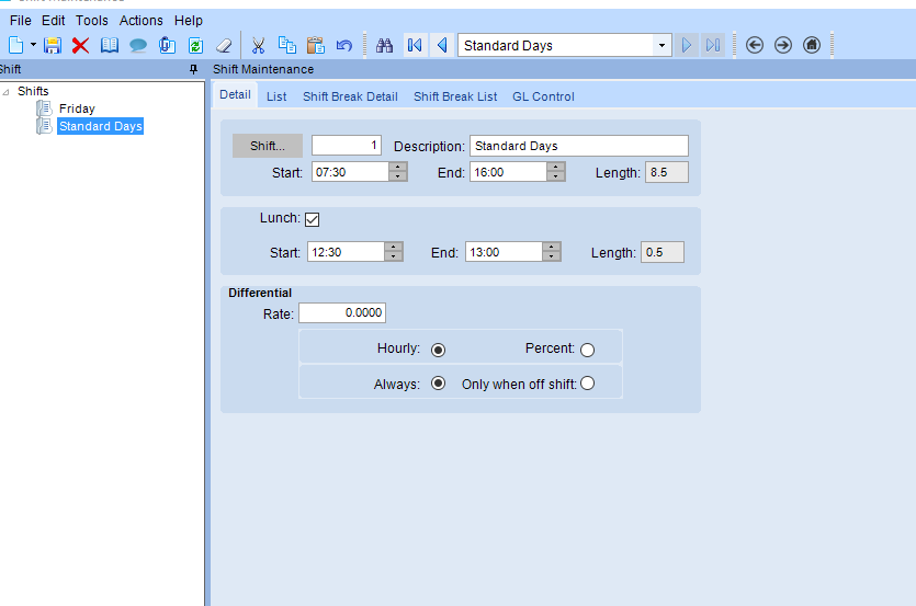

You can use Shift Maintenance to define breaks, you can add as many as you like.
