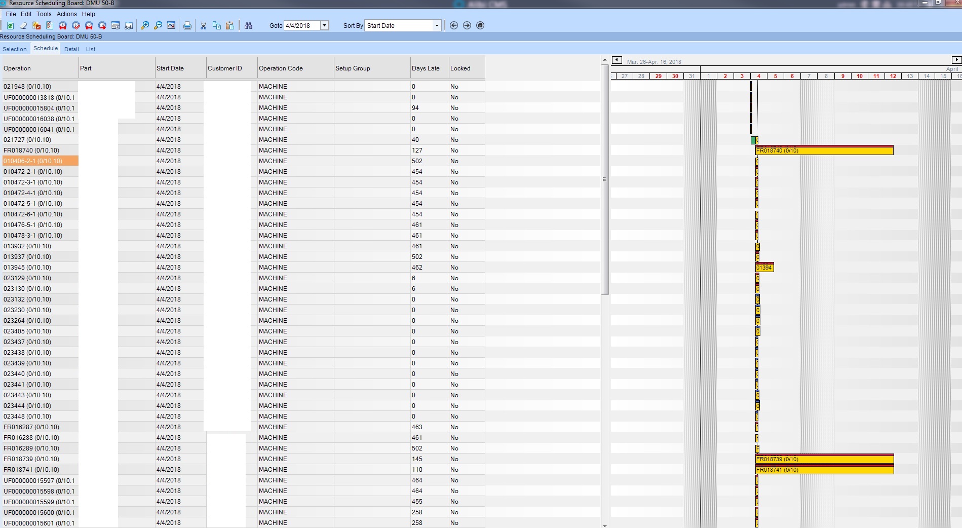

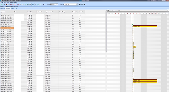

So here’s our first Resource Scheduling question…
In the Menu “Action” items, we used “Load Level” to reschedule all jobs to the current day and beyond.
However it’s stacking jobs on the current day without “leveling” them into the future. Help! Why is it doing that?!
Screenshot below…

Maybe this image works!! Apparently E10Help likes jpg instead of png.
It would appear that your resource is most likely set to infinite capacity. Change to finite and then reschedule
Might also be the finite horizon - if these jobs are scheduled beyond that, they will schedule infinitely no matter what.

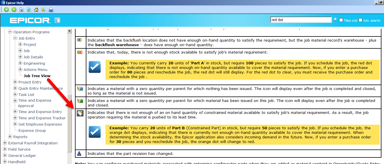

We have a job which Scheduler is bumping out from May to Oct. It appears the constraint may be on material delivery. Mtl: 10 shows a yellow tag with yellow dot. I’ve never seen the yellow dot before. What does that represent?
BOM
Any chance user help RE constrained part is applicable for your here?
Thanks Nancy. Yes, that was very helpful. Great resource.
