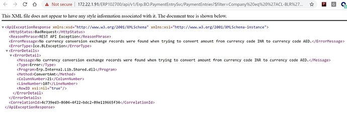

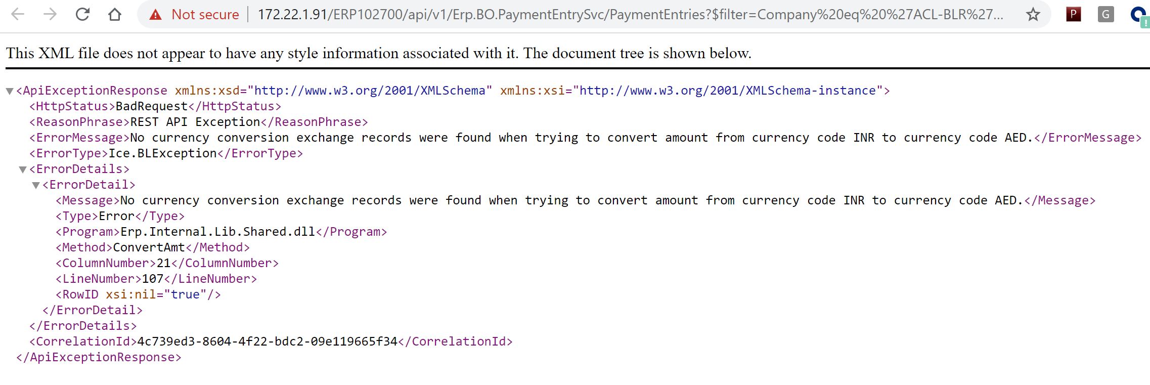

I have E10 setup with seven companies out of which five companies are with the base currency as UAE Dirhams, one with Indian Rupee and the other with Bahrain Dinar. For the currency with UAE Dirhams the Rest API of Erp.BO.PaymentEntrySvc works fine and provides the desired output but for the ones with Indian Rupee and Bahrain Dinar as base currency, i get the attached error (No currency conversion exchange records were found when trying to convert amount from currency code INR to currency code AED)
. Currency setup were checked with support team and found all okay.
This was a bug in E10.2.100.20 and also in the latest 10.2.700.15 version and is still under investigation.
Has anyone come across with this bug and have a solution.
