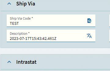

It happens in Kinetic UI too!
That makes sense, as Kinetic UI is built on REST.
Just enter 2023-07-17T15:43:42.461Z in any description, address or whatever field, save, and refresh.
It does not happen in the Classic Client.
Kinetic:

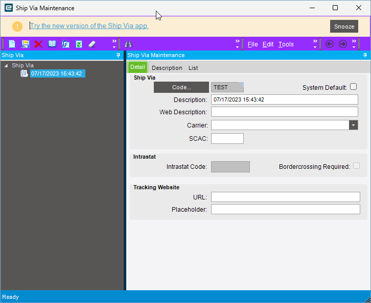

It definitely is in the Write because when I refresh the Classic Client:
Have not tried Kinetic UI in the smart client yet, just the browser.
