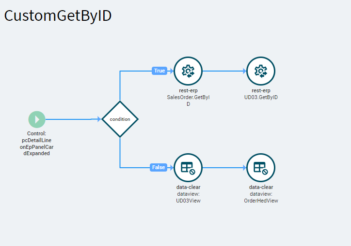

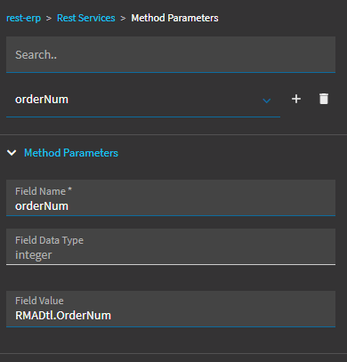

I’m using the rest-erp widget in application studio to pull information into Case Entry, RMA Processing, and Service Call Center. RMA Processing and Service Call Center are both giving me issues, while Case Entry is working as expected. My error is coming from the UD03Svc call, but there is something wrong with the information coming from the SalesOrderSvc call. Here is an overview of what I’m trying to accomplish:
Once in Line Details, I want to use RMADtl.OrderNum to pull in order information (we have some UD fields that correspond to UD03 on our OrderHed table). Then I’m trying to look up the records in UD03 based on this order information but I receive this error:
Parameter key2 is not found in the input object

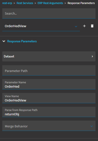

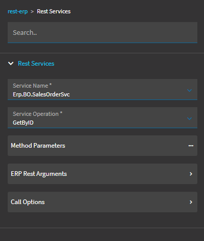

I have been fiddling with this all day. It is set up identically in Case Entry, yet I run into zero issues when using that application. Below are some screenshots of my SalesOrderSvc call.
Any ideas would be greatly appreciated. I used the rest api help tool and running through the SalesOrder and UD03 services there I am seeing the results I want.

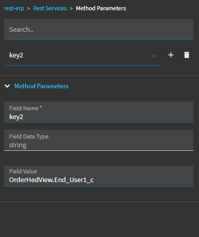

Are you sure the error is coming back from the SalesOrderSvc? There is no Key2 parameter on SalesOrder.GetByID … but there is a Key2 on UD03.GetByID which you call immediately after. Maybe the issue lies in that second rest call?
Hey Jonathan, yes, the error is occurring on the UD03Svc, but it’s occurring because there is no order information from the SalesOrderSvc. Does that make sense?
For the UD03Svc call key1 is a hardcoded value, that’s why it’s not throwing an error, key2 references that OrderHedView from the previous call.

and what you are showing looks exactly as I would expect - based on looking at what I made last week for UD13 BO
Do you see the network call to SalesOrderSvc going through? To clarify: is the response coming back empty? or is there data in the response, just not in the data view (OrderHedView)?

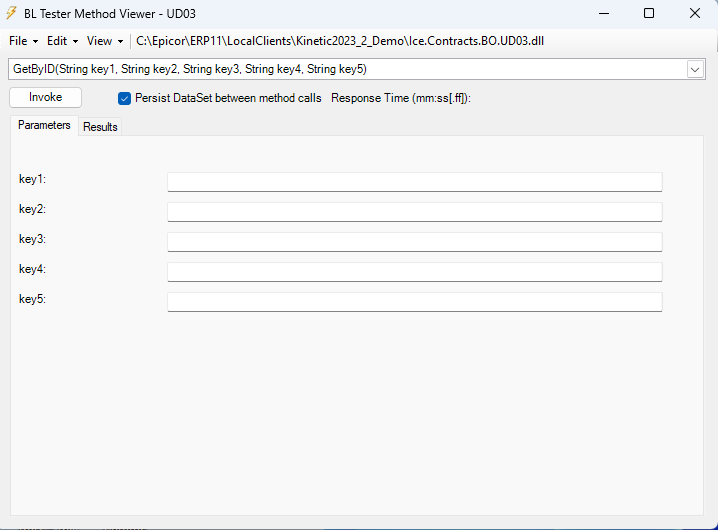

Test the UD03 getbyid with the BL tester (if you can)
I think it requires all key fields to be populated… even if they are empty

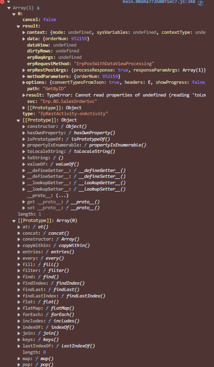

Good morning Jonathan. This is what I’m seeing. Don’t see any data returned.
Could it just be that some services can’t be called from RMA Processing? The only data I see is the OrderNum I’m passing to SalesOrderSvc.
Simon, you are correct. I’m passing through blank values for key3-5
This is showing an error coming back from your SalesOrderSvc call:
I can’t see all of it, but something is undefined.

This is the error:
Cannot read properties of undefined (reading ‘toLowerCase’)

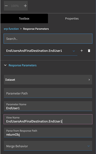

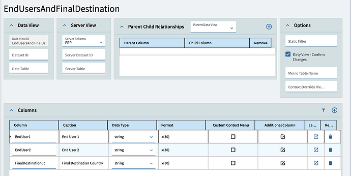

Okay, I am having trouble getting the response put into a view. I have done this with built in Epicor services and it worked fine, but basically I would create a view from OrderHed, then pass the OrderHed parameter to the view. Since this is custom I’ve created a view with identical column names to my 3 main parameters and attempted to pass each parameter to the view separately, so far I have been unsuccessful. Does anyone see anything obviously wrong with either the view I’ve created or the set up of my function?
@klincecum @dcamlin

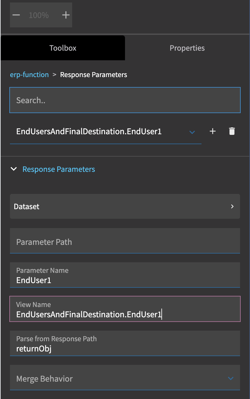

I have also attempted to set the parameters up like this:
Here are the response parameters, I’ve confirmed they are returning successfully using REST API Help:

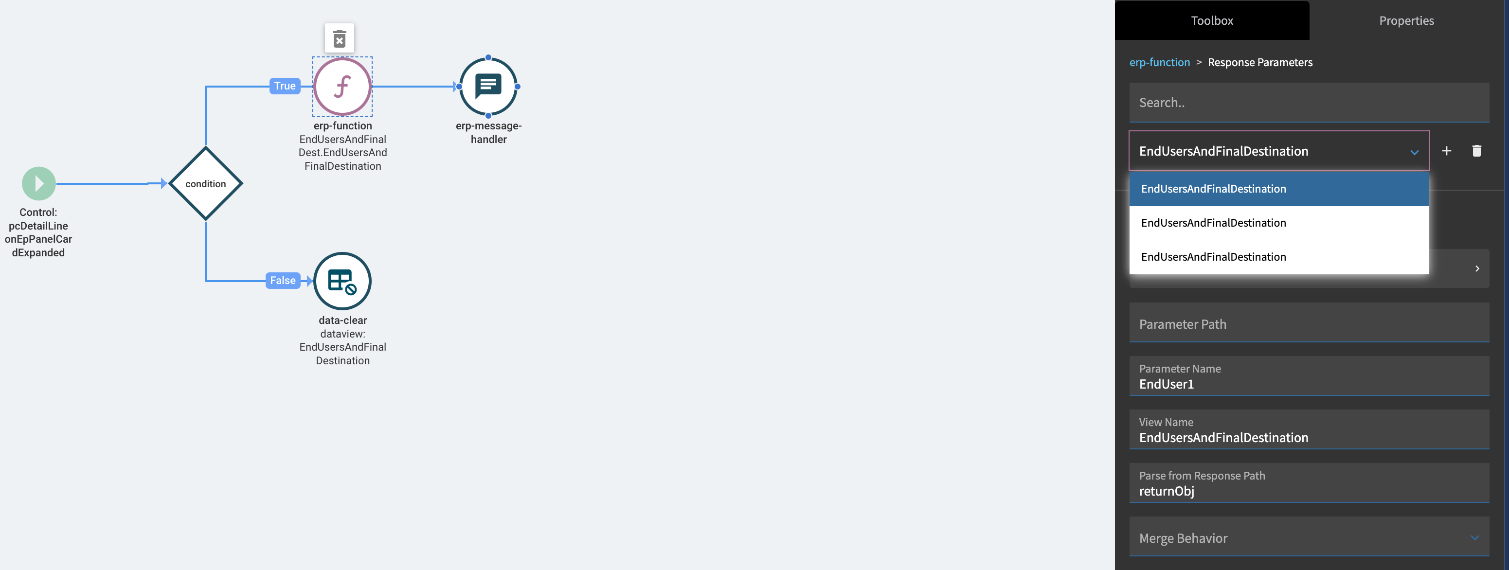

I don’t see the little arrow on that diagram on the function.
Possible the event is corrupt.
I will attempt to rebuild the event then and see where that gets me. I had never noticed that. Looked at another event and sure enough it does have the little arrow.
