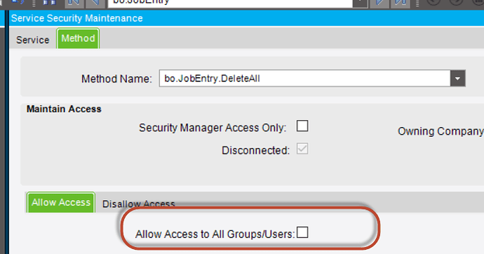

What Business object are you using?
Craig
(Craig Rogers)
May 30, 2022, 2:43pm
8

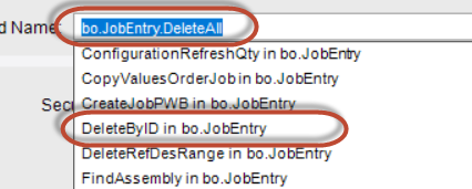

make sure to uncheck this.
and on the method, you may have to run a trace log to see what method is called in delete.
it might be one of these.
