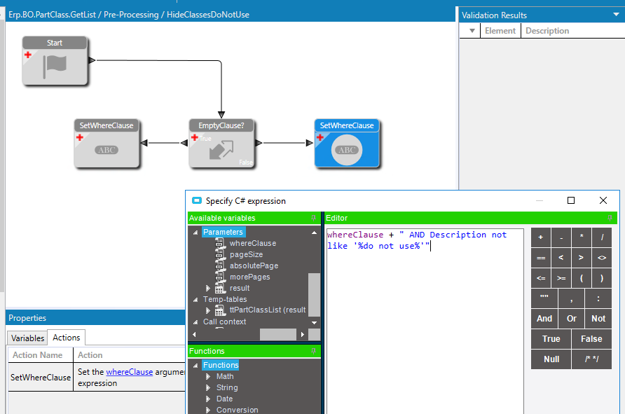

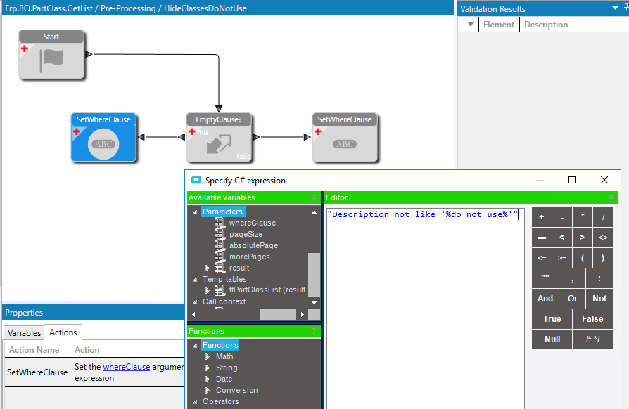

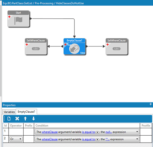

I’ve been testing this with PartClass. I have the BPM ready to go but I haven’t enabled it yet. From my tests so far, it seems to be working. I’m changing the whereClause with a pre GetList BPM similar to what @timshuwy did there. I’ll add a few important things below, they are probably related to the issues you mentioned.
When you’re using the form (Part Entry for example), GetList is not called until you click on the PartClass dropdown. So GetList doesn’t populate the selection in the dropdown, that is done before GetList is called (my guess here is GetByID).
When you change the whereClause, make sure you’re not overwriting it. You’ll need a null/empty check first. If whereClause is empty you just set it (whereClause=“Description not like ‘do not use’”), if it’s not you add it to what’s already there (whereClause=whereClause + " AND Description not like ‘do not use’").

LE: the BPM I have
