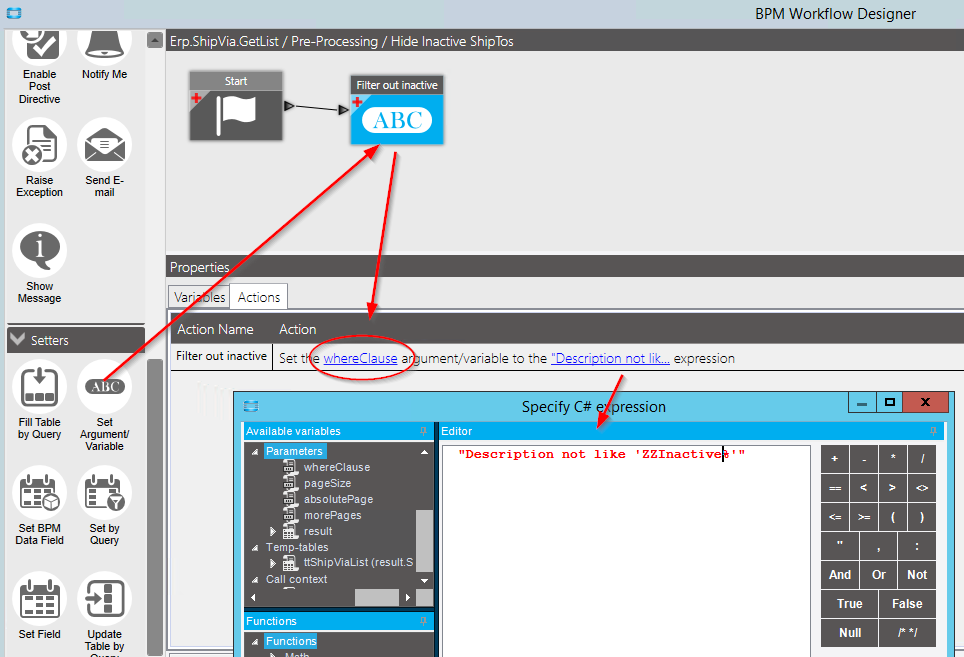

  1. Create a new METHOD BPM in ShipVia GetList as a PRE-PROCESSING BPM
  2. add a new “Set Argument/Variable” widget
  3. change it to say "Set the whereClause argument/variable to the specified Expression
    In the specified expression, enter the following line of SQL code (including double and single quotes).
"Description not like 'ZZInactive%'"
Save and activate the BPM… THAT IS IT… the whole enchilada… All I had to figure out was the SQL Syntax, and I learned that by searching the internet (google: “Sql string does not start with”)
Now, anyplace that has a combobox list for ShipVias (which use the GetList function) will automatically hide the entries that begin with ZZInactive in the description (or ZZ or anything you choose to make it).

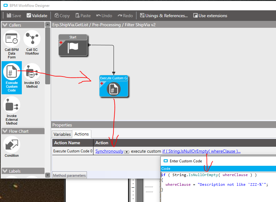

Hi Tim - This is great and I started using this. I recently found out that the way you have this setup will prevent the Tracking buttons from working in Customer Shipment Entry, Subcontractor Shipment Entry, and Subcontractor Shipment Tracker as the Tracking buttons use the GetList method. This is not a problem with Customer Shipment Tracker as the Tracking buttons use the GetByID method instead. I have figured out how to adjust your BPM using the Execute Custom Code with a simple if statement. This has use Synchronously as it would not work Asynchronously. The code is below along with a screenshot like you did. You will notice that I used ZZZ- as my prefix instead of ZZZInactive.
if ( String.IsNullOrEmpty( whereClause ) )
whereClause = “Description not like ‘ZZZ-%’”;
Pete Chikes

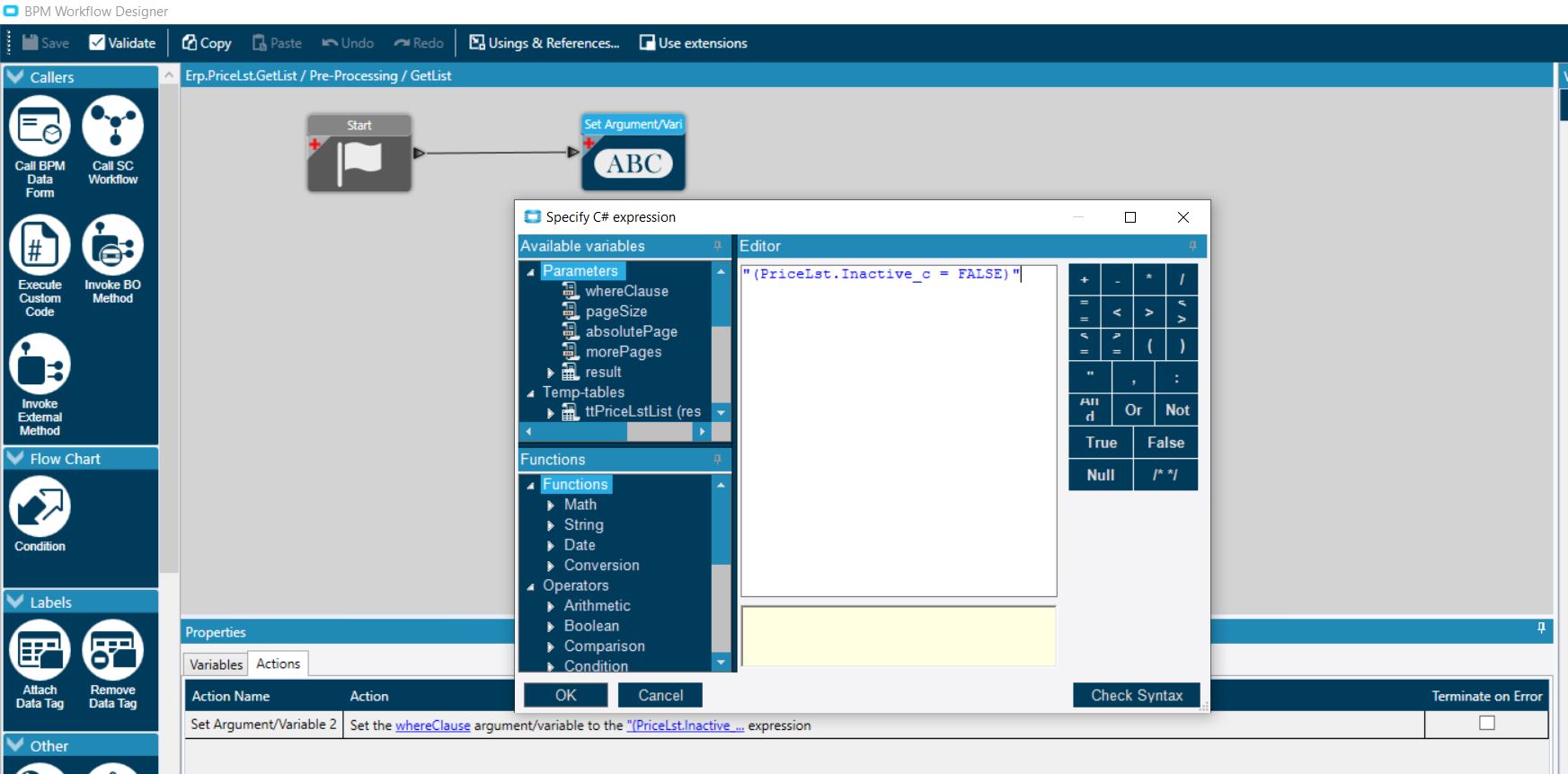

I have added the custom UD Inactive field in Customer Price List. But how to usee Inactive_c in where clause?
The Set Argrument/Variable Widget, returns a value to which the arg (or variable) you selected, will be set to.
Just make the expression:
"PriceLst.Inactive_c = FALSE"

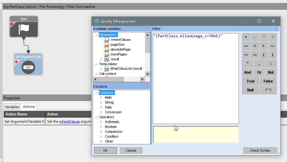

Here’s the PreProc MD BPM we use for limiting the PartClass
I wish I had named the UD Column Inactive_c - to keep with Epicors convention - but actually went with AllowUsage_c, which then requires the opposite condition (TRUE, vs the FALSE used with “InActive”)

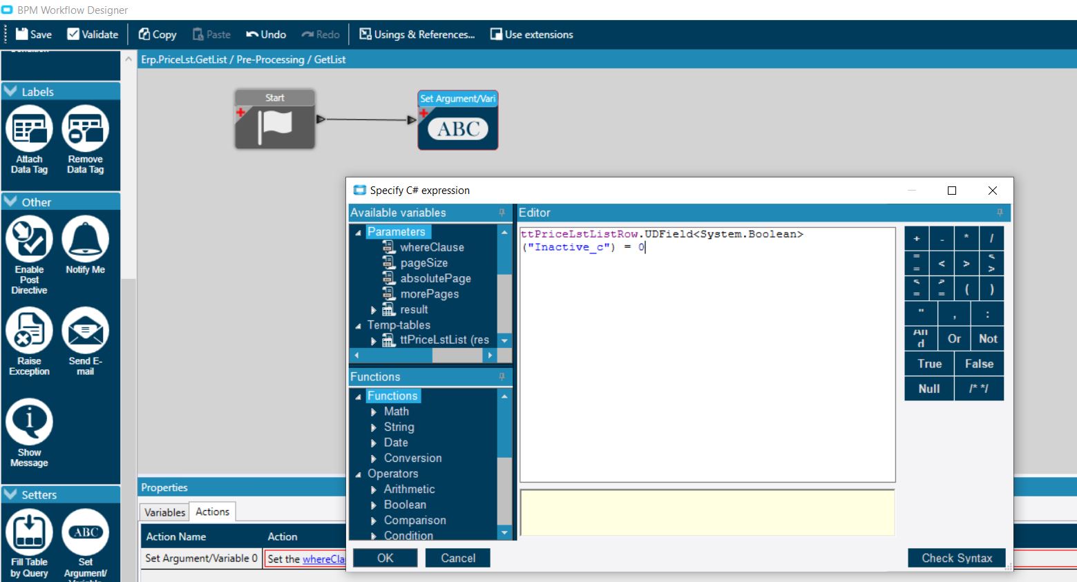

As per your suggestion, I did the same but still inactive records are coming in the list. for your reference screenshot is attached.
