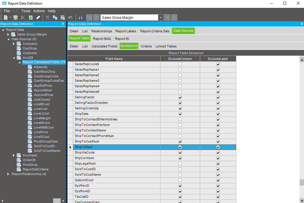

Have a look at the Report Data Definition (RDD) first.
By default, it looks like the ShipToNum has the ExcludeColumn checked.
If you want the ShipToNum to come through, copy the Report Data Definition, and change your report style to use the new RDD with the ShipToNum not excluded.

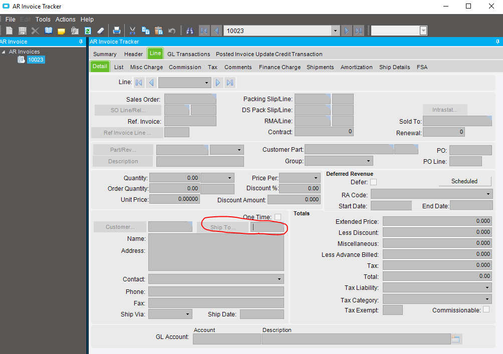

Thanks for the reply Toby. I managed to make some progress on this. The issue I’m having now is that the ShipToNum only shows up for invoices where the customer only has one ShipTo address. Regardless of what’s in the ShipToNum field on the invoice, if the customer has any other ShipTo addresses then nothing shows up.
I believe the Ship To num refer to the ShipTo field, it is not a required field. I have a lot of invoices that the order entry person just leave it blank.
But if you have data in it and the report not showing it, meaning there should be changes to the RDD.
