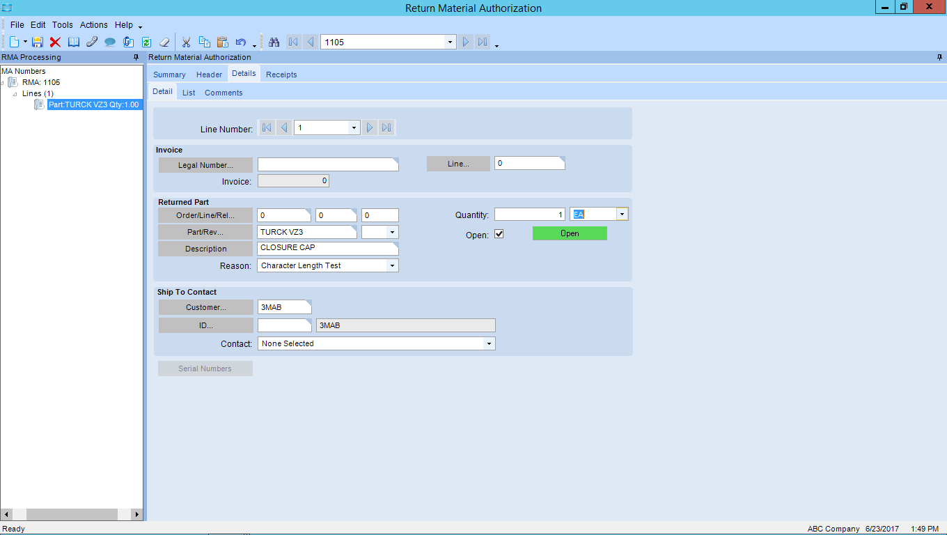

Calvin, a Sales Kit is just a convenient way of grouping items together for
ordering and shipping. You can return any item through an RMA without
referencing a sales order and line. You will need to receive the RMA item
and disposition it through inspection (which makes sense anyway because
something being returned from a customer is suspect anyway until inspection
reviews it) and then from disposition entry put that part into inventory,
or dispose it if you want. See below screen shot without a sales order
But that the return of that part doesn’t reduce the COGS related to that order. The tests I did have the RMA crediting (or debiting, I can’t keep them straight), the Inventory account, with an Inspection account ass the offsetting one.
That’s no better than an Inventory Adj that credits/debits the Inventory account and a Variance account.

To add on to Mark’s example, you can enter the Sales Order here and leave the Line / Release blank. Also, you can enter the Sales Order, Line and Release and then override the Part field with the actual part being returned.
