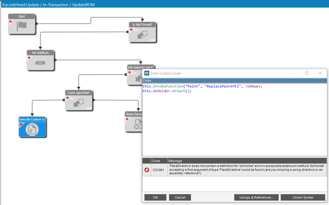

I’ve tried it as a method directive (pre and post). I’ve tried it as an in-transaction data directive. And I’ve tried it as an in-transaction data directive that calls an epicor function, but I get the same error no matter what. Any idea how to get this update to go through without the error?

Does this advice apply to a data directive? Where would I add that ? This didn’t work (didn’t expect it to though):
It would not you would have to give the dsholder an actual dataset to attach. Would need to use call context or something to let the post processing, causing this data directive to fire to do a get by ID and pull the new data in. The SysRevID drives this functionality. You need a dataset with that new sysrev.
