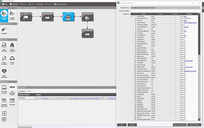

I’m triggering it in a function using the Invoke BO Method caller for Erp.MultiCompanyDirect.SubmitToAgent rather than using C# code, and it seems to be working fine, but I’m still using it in test only. We have 4 companies involved, and as was mentioned by others, it needs to run in all the participating companies. But using the “TenantMode” = true flag in the parameter set, the system handles that and you only need to run in one company.
(The ExtCompanyList was an attempt to exclude one company, but since I ended up using TenantMode, that list gets ignored.)
Sorry if this is considered hijacking the thread, but the issue I’m running into is that I’m trying to create global customers in all companies after they are created in the parent company. I need to know that the Multi Company Direct process has finished before I can proceed with the linking. (As Josh confirmed, the Sleep is not a good idea.) The SubmitToAgent method returns to the code once submitted, so doing the linking won’t work at that point. The documentation for the API for Erp.PROC.MultiCompanyDirectSvc has a RunDirect method, but when I call it I get an “Object reference not set to an instance of an object” error no matter what I have tried in the parameter set. Epicor Support has informed me that the RunDirect is not actually an option for this, and they have made a note to the development team to remove it from the documentation.
Do I take support at their word that RunDirect will not work, or are there any tips on getting it to work? I have seen other threads that talk about adding something like a comment to the task and checking if it is still active, but I was hoping the RunDirect would just work like it says it does.

It would create globally linked records. The linking process would occur in the child company where the customer record doesn’t yet exist. The process flow is as follows:
  1. The sales rep creates a new customer in the parent company.
  2. Upon saving the record with the global flag selected: a. The MCD runs, creating records in the GlbCustomer table for all child companies. b. The code then executes the LinkGlbCustomer method to link the customer in each child company.
  3. Appropriate checks are performed where required, similar to those in the manual process.
Currently:
  • I can call the MCD with SubmitToAgent.
  • I can link a new customer in each child company when the record exists in the GlbCustomer table (i.e., create new and link).
The challenge: I haven’t been able to run both processes in the same function because I can’t verify when the MCD process has completed. As a result, the GlbCustomer record may not exist in some or all child companies when the LinkGlbCustomer method is called. While the ‘Sleep’ option has been suggested in various places, it seems like a bad idea.
I have considered displaying a message telling the user to wait 30 seconds before hitting OK, but I would also like to call this function from other sources using API, and I haven’t tested how the API handles message boxes in functions.
Are there alternative methods to either:
  1. Confirm the MCD process has completed before proceeding, or
  2. Implement a more reliable way to wait for MCD to finish before proceeding?
For background, we do run the MCD on a 5 minute schedule, but for the sales rep, that is an eternity. We also want to remove the manual process of linking customers in each of the child companies. This workflow would make new customers available in child companies almost immediately.
