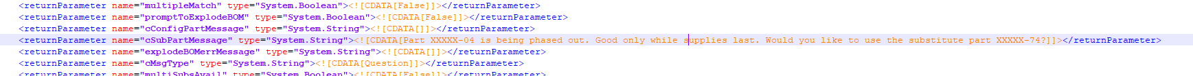

I went through the trace log and found the cSubPartMessage field
but when I go into the post processing BPM Designer and select the set field widget I don’t see the field in any of the data tables. I assume it would be in OrderDtl thus the screen shot below but I actually checked each of the temp tables.
I see based on your code snippets that you seem to be using the custom code widget instead of the set field widget. Is that because of your familiarity with the custom code widget or is that the only way to access and modify that field?

You need to look for the parameters, not table fields.
Not sure what they are called off hand. Help guys?
Set Argument/Variable
