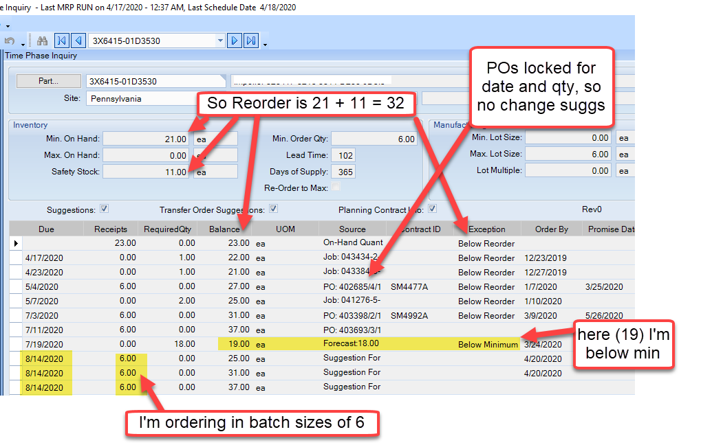

Hi Andris,
I think you should. Here are a couple of examples of our timephase where we use MOH plus allow consumption of MOH, in case it is useful to see it in action. There’s a below reorder and below SS shown respectively.
Hope this helps!
Nancy

I came up with this a while back, if you’re a visual person. It’s helped here.
MRP - Min max and safety in Epicor.pdf (540.4 KB)
