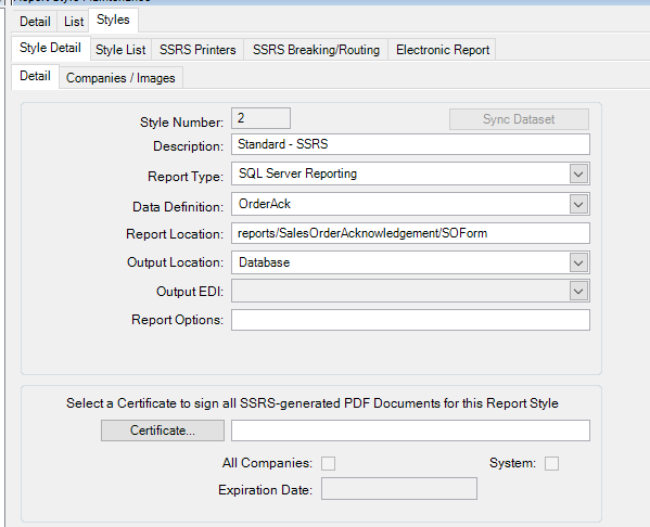

Either way you can still do a suppression of the section in the report. You should be able to tell by going to the Report Style screen and looking at the OrderAck report style. There you should be able to see the default style for when you run reports.
This is what i see. Sorry not sure how to do this:

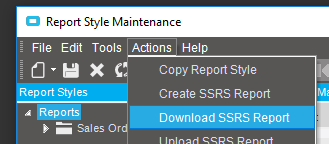

  1. First you will want to go to Actions > Copy Report Style. You NEVER want to modify the out of the box report, also copy a style and make sure the report is pointed to the customer reports folder. This should automatically be done for you when you copy.
  2. Once you have your custom style, you should be able to go to Actions > Download Report

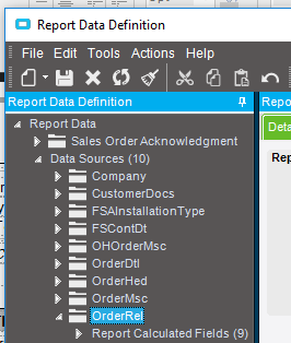

  4. The field you want to suppress based on is actually not in the report Out of the box. You will need to duplicate the RDD which is your datasource for the report. Right click open with
  1. Actions > Duplicate Report
  2. Go to the tab Data Sources > Report Table > Exclusions
  3. Find and select the OrderRel table from the tree. You will see the exclusions grid refresh.
  1. Look for the field name OpenRelease. Make sure the ExcludeColumn checkbox is UNCHECKED. We don’t care about the label. Save
  2. After you have created your new RDD. You will need to make sure your new Report Style is using it, so change the Data Definition in the drop down.

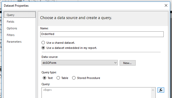

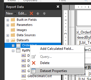

  3. Once you open the report from the downloaded location, Lets add your field into the report so we can use it in an expression. Datasets > OrderHed > Right Click > Dataset Properties

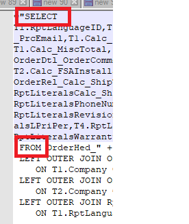

  1. Click the formula icon to modify the query, then copy out the text to a text editor like notepad or notepad ++ for better viewing

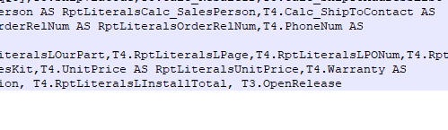

  2. Quick lesson basic SQL. Look at 2 of the 3 main sections in this query. SELECT & FROM. SELECT is where you say I want to see these fields from specific tables in my query. FROM is where you define and link the tables together. In this case our table is already in the query, so we don’t have to add the table. Just find the table and its alias T3
  3. Add this to the end of the SELECT statement with a space after it
    , T3.OpenRelease . Then copy the query back into the report

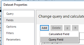

  4. Once its in your query, you have to define it as a field to use in the report. Dataset Properties > Fields > Add > Query Field. Type the field in just as you did in the query

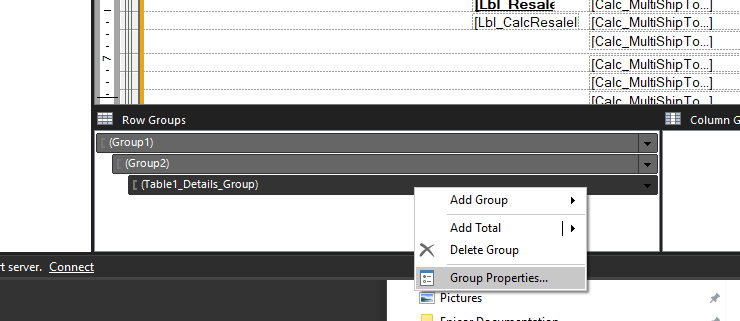

  5. Now that we have done all that work just to get your field in the report, you can use it in a row group expression. Row Groups > Table1_Details_Group > Right Click > Group Properties. You can confirm this is the Order Release group by
  6. In the Group Properties screen, Visibility > Show or hide based on an expression > Fx button. Use the below expressione. Save the report.
    =IIF(Fields!OpenRelease.Value = FALSE, TRUE, FALSE)
