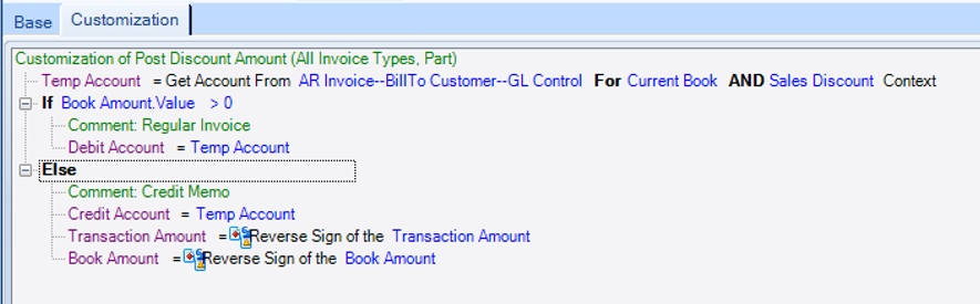

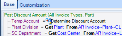

@nanvdand This should be simple with a custom posting rule. They are not hard to do just have to understand the process. Two possible places both in AR Invoice
  1. there is a function Determine Discount Account. While functions are called from everywhere they also don’t have the nice custom code separate area where you only have to add your extra needs.
  2. There are three Post Discount Amount rules for parts, contracts and calls. you probably only need to make the part one custom.
Epicor determines Temp Account from the function
something like this should work. I don’t know about dynamic segments. We don’t use them.
turn on PE logging and check the manually review all transactions and you can run an edit list and check where it be sent.
The one pain is that you have to activate the rule to test, so I made it from A G last week before I got a set finished.
