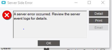

Are staff our having issues when entering SO with a large number of lines 65+. Are the any maximums/recommendations? Also, this error is occurring frequently:
Where is that log file?

If you go to the event viewer on the epicor server you can find the additional error details there.

You can see the error details on the Windows Event Viewer, also you can enable server text logging through the AppServer.config file.
