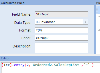

You can then create calculated fields in your BAQ:
For SORep1 (again, you won’t need the (2) after OrderHed)… we want the first “entry” in the OrderHed.SalesRepList:
For SORep2 we want the second entry:
wash-rinse-repeat for SOReps 3 thru 5 if desired.
