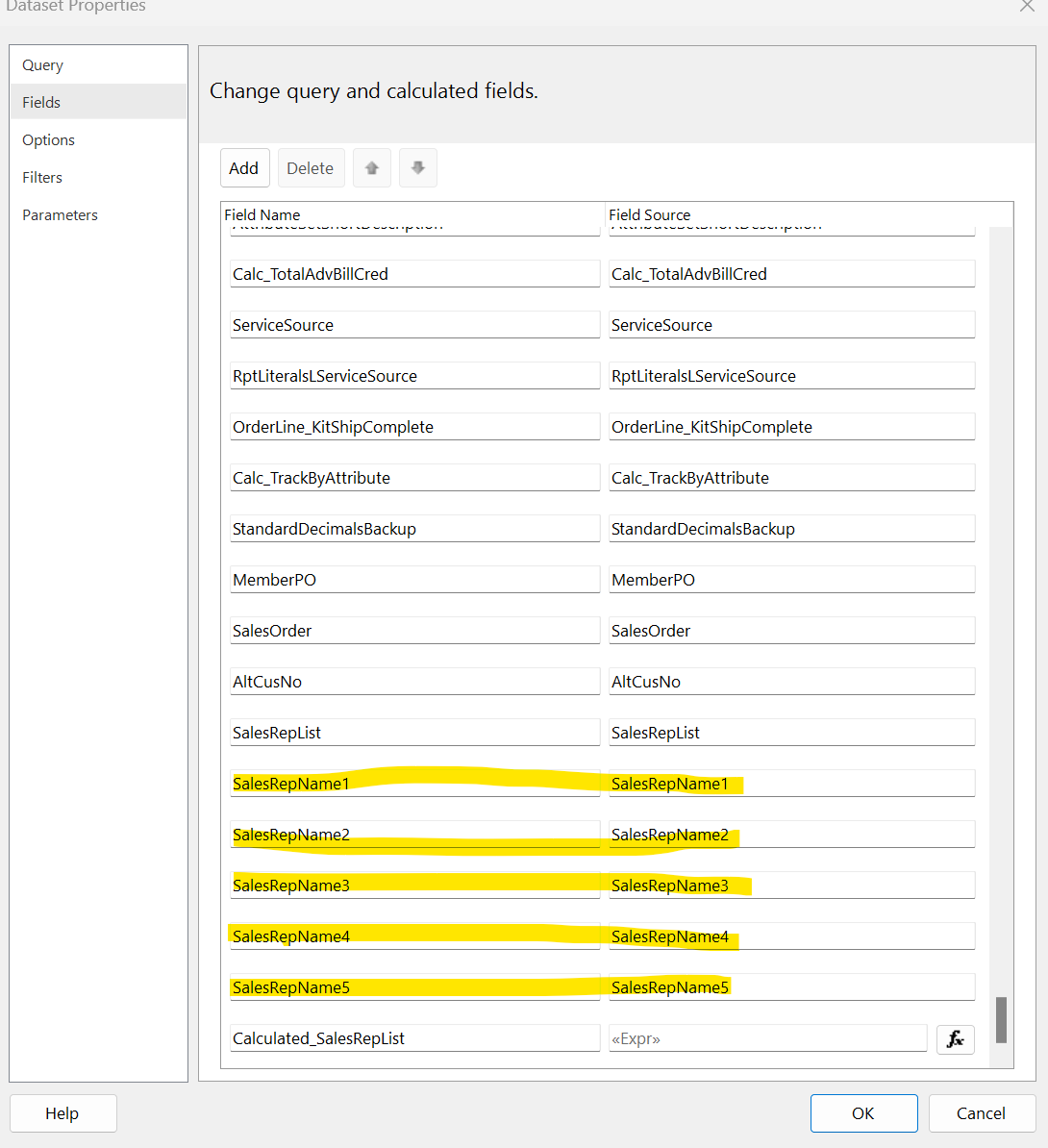

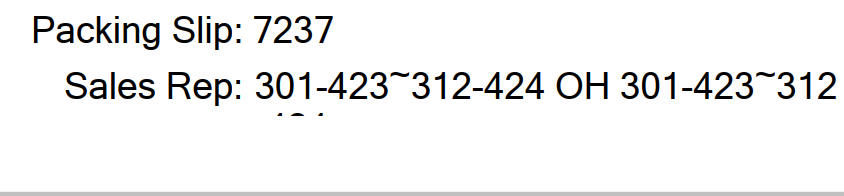

I’m attempting to fix our AR invoice and show, at the very least, the top 3 sales reps for an invoice. I’ve gone into our RDD for the invoice, which was originally copied from the base definition, and excluded the SalesRepName1-5 as well as SalesRepCode1-5.

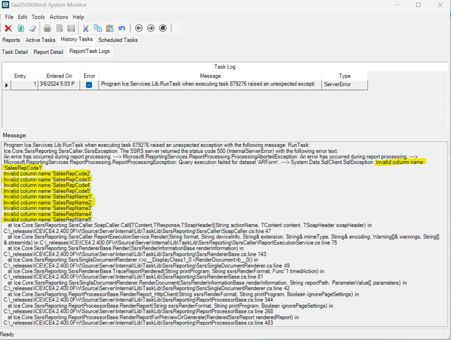

I added the fields to my SSRS report for the invoice but when I run it, the system monitor tells me that the SalesRepName and SalesRepCode fields (1-5) are invalid?

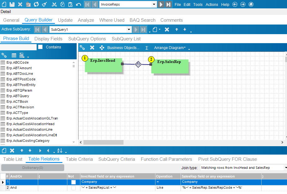

I tried finding them in a BAQ for InvcHead, and I didn’t even see the fields at all. Am I missing something here?

The fields are set up near the end of the select.
Just out of curiosity did you add the fields to the data set outside the query then?
Sure did!

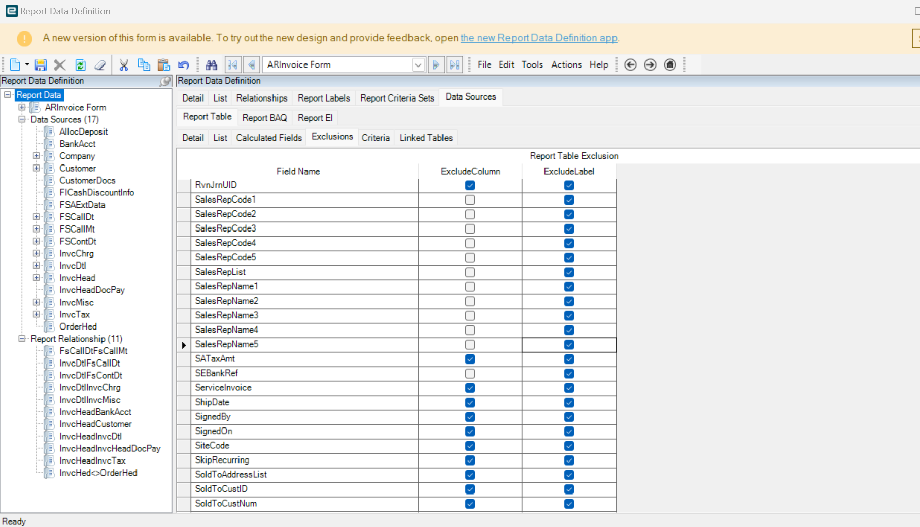

Changed the data definition on the report style screen to match this one if it wasn’t already?
Im not a SQL expert but nothing stood out to me why that query wouldn’t work with those added.
Correct, and agreed. RDD’s just seem to make simple fixes a headache when they don’t work like expected. :frowning:
I mean I had a scenario when I first started out where I did everything to add a table in and it wouldn’t work. The guy who was teaching me couldn’t find anything either he was like just start over and see what happens. When I did everything the 2nd time it worked like a charm. That was the day I learned to dislike SSRS reports.

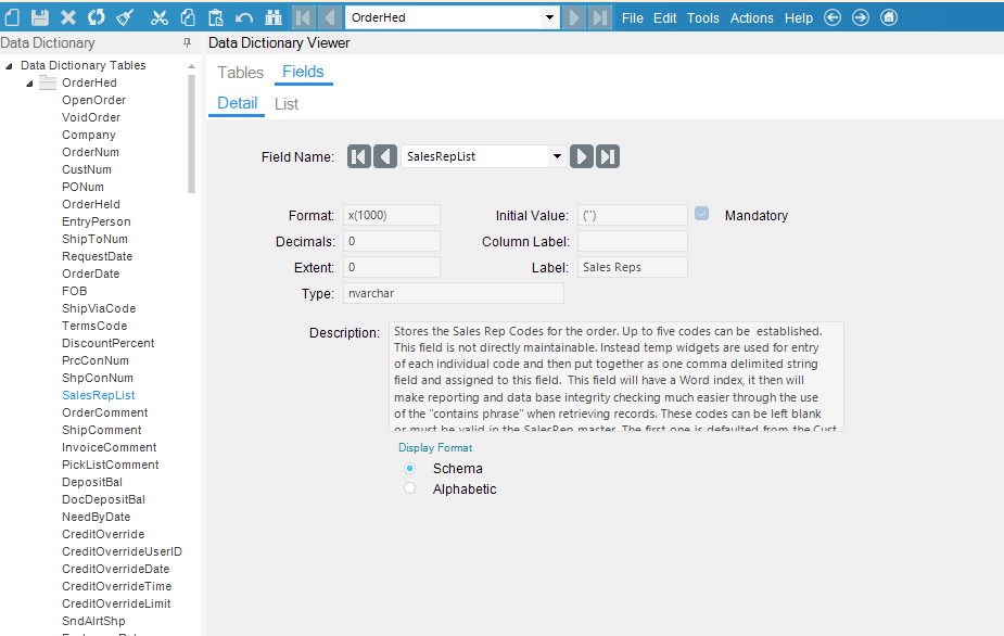

It doesn’t look like the SalesRep fields exist in the InvcHead table. You may need to figure out the correct join to bring this back. Per your query, T1 is a table alias for InvcHead.
T1.SalesRepList,
T1.SalesRepName1, T1.SalesRepName2, T1.SalesRepName3, T1.SalesRepName4, T1.SalesRepName5
FROM InvcHead_" + Parameters!TableGuid.Value + " T1
I agree with you though, any of these RDD based on tables are a pain to deal with.
I mean if this were a BAQ we would need to link in the SalesRep table right?
Yeah and there isn’t really any direct relation between the InvcHead and the SalesRep table. You’d have to find another table to join through.
I see you have OrderHed, it may just be figuring out how to join OrderHed to the SalesRep table. It looks like the Sales rep codes/primary keys are saved in an array in SalesRepList
Right, right. I might have to try pulling the list into the report and splitting it, and then attempting to inner select straight into SalesRep from there. It doesn’t seem like I can directly joining a value from the SalesRepList field into the SalesRep table.
Splitting probably is the way to go on that front. If you remove your salesrepname fields from the query and the field list does the report run?
Yes it does. If I just load the SalesRep fields (right now, I have both of them from InvcHead and OrderHed, just to confirm they’re the same), they populate in my invoice. Now to just figure out how to do the rest…
Are you going to use it as a single list of names? or do you need to be able to separate the values? If its just a list you can use replace.
Ultimately, I need the full sales rep name for each code.
So, I do need to split them out, match them to the SalesRep table on the code, and then show the full name.

There is a trick that people did back in the Vantage days, and I’m sorry that I don’t remember who came up with it, but here’s a BAQ that will create a record for each sales rep for you. Here, I did it with InvcHead but it works the same with OrderHed. The trick is to use this fancy expression in the linkage.
InvoiceReps.baq (18.8 KB)
This could be great! Am I able to use a BAQ to link to within an RDD though?
If it wasn’t a smaller change, I’d consider throwing out the RDD altogether and just making a BAQ Report out of the invoice…
It’s been brought up a lot, but not yet anyway. :person_shrugging:
