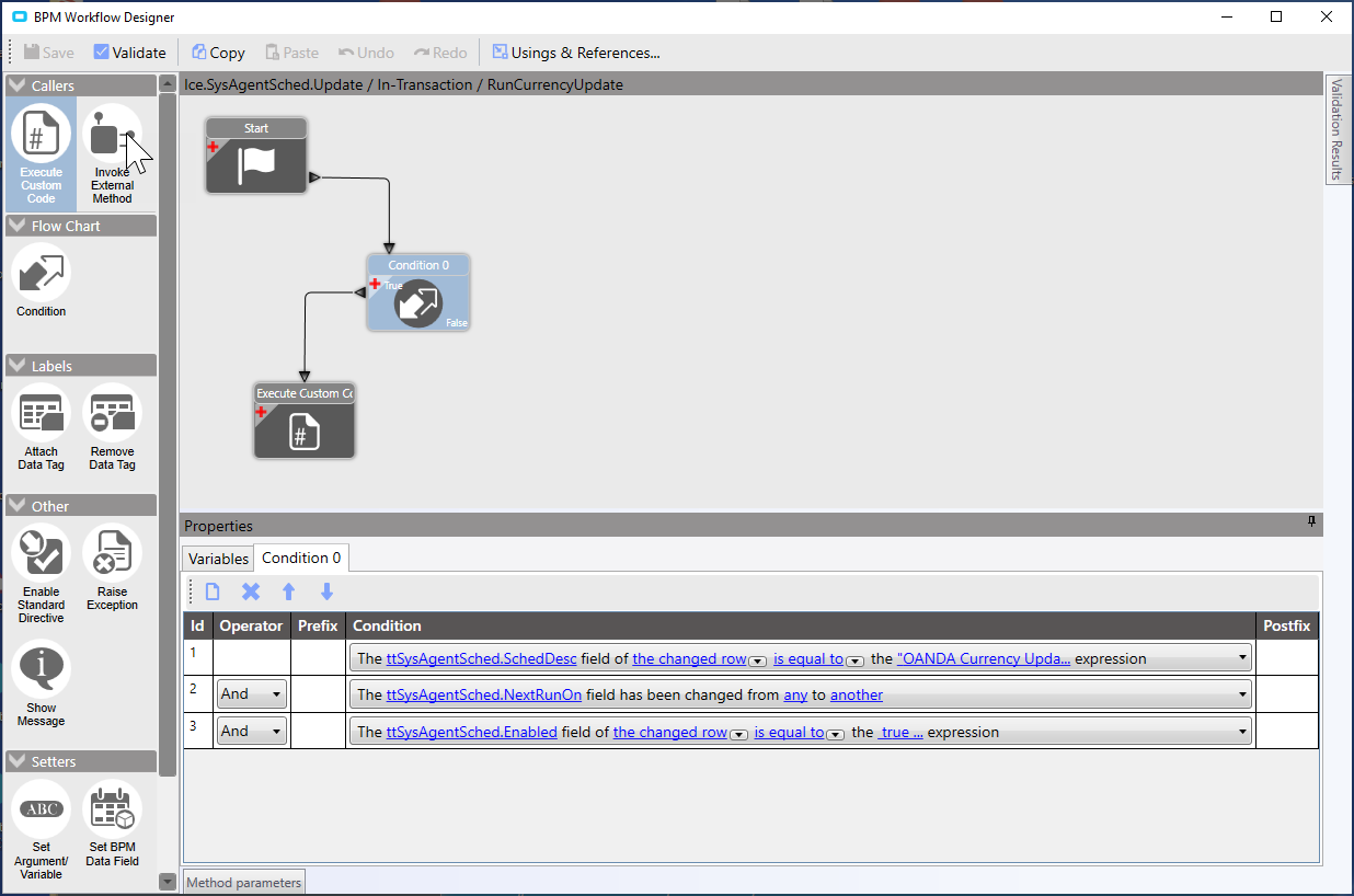

Solution - using the Task Agent schedules, you can create a schedule that has no tasks, but can trigger a BPM that is itself selective in identifying if it should run or not. I’ve provided images that should explain it all. Every time the execution date/time triggers, it updates to the next interval and THAT is the change that triggers the BPM(Data Directive).
My example runs a chunk of custom code to retrieve currency conversion rates from the OANDA website.
First, start with a schedule that has no tasks, but is named accordingly.
Second, create a Data Directive.
Third, set a conditional block that allows control over the execution of the DD. The first condition checks to see if this is the correct schedule to fire on, and the second condition makes sure the interval changed/expired and that it is time to fire the DD. The third condition allows me to control the run-state by using the enabled checkbox on the schedule rather than editing the DD directly.
