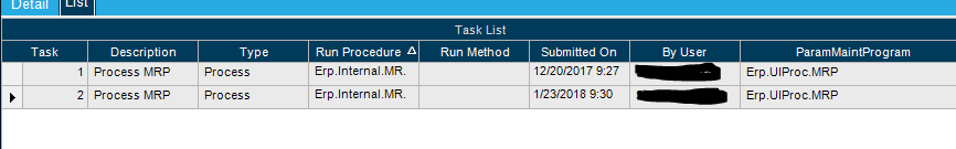

Where can I find the actual parameters of MRP that is run by a schedule? I find the task in System Agent, but I have yet to find the details\params.

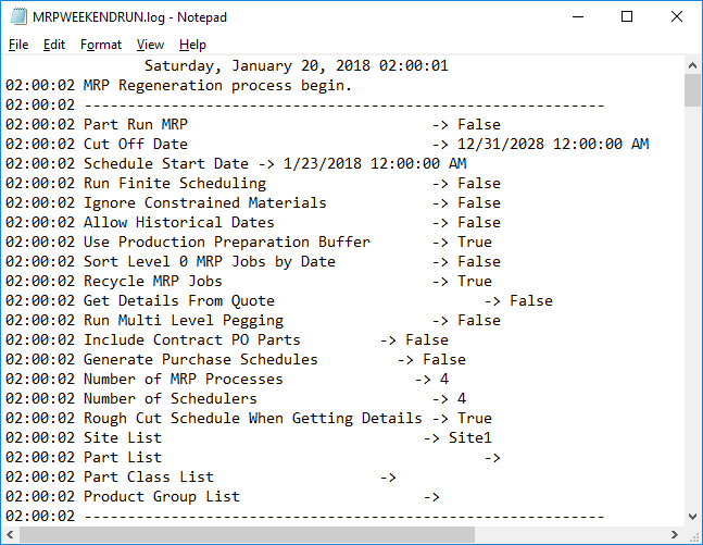

If you look at the MRP Log files in \EpicorData\Companies\CompanyName\Log\UserName usually the MRP_LOG_NAME.log file contains information about all of the options that were selected for that MRP Process run. :slight_smile:

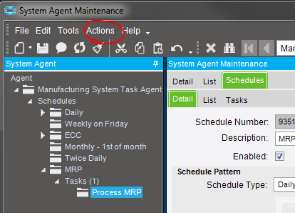

Go to System Agent, then expand the tree (ours is called Manufacturing System Task Agent)
Find the corresponding Schedule and expand, then click on the Task. Then go to Actions>View Task Parameters
That is so cool! Thank you @lgraham, I had no idea you could do this! :open_mouth:
Lol - I ALWAYS forget to check the menus! Thank you very much.
